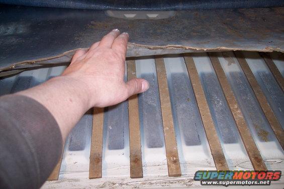

I've never owned a bullnose but later generations used cardboard slats between the floor ribs, fwiw.
Looks like a good bit of work but very restorable, so that's good news.
One thing a lot of us have done over the years but usually just "when needed", is to cut an access hole into the floor of the cargo area to access the fuel pump without draining and dropping the tank. Sooner or later, it always comes up. You might even consider a preemptive strike but that's all up to you. I'm just tossing this out for your consideration, while you're there anyway.
Once it done and done right, you'll never even know it's there... until you need it.
Hey @BikerPepe` that's crazy. That's exactly what they seemed like was thick cardboard... U wouldn't think that would be a good rust inhibitor. Good idea about the hole for the fuel pump, but wouldn't that also leave u succeptable to rusting? Remember I'm in North West PA and eventually moving to Alaska so I want to make sure she's weather solid.

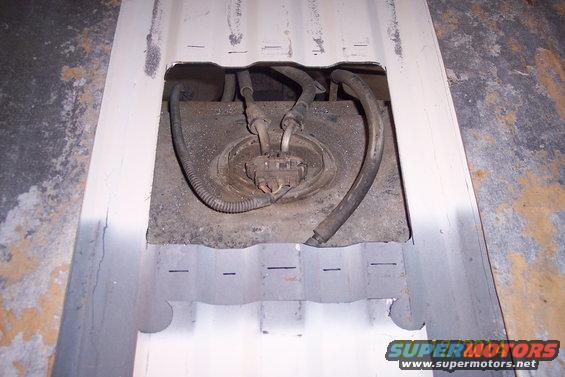

The evil Steve83 also did a great write up on cutting the fuel pump access hole:
https://www.supermotors.net/registry/2742/33276-2
I was a little leery of using a saw or wheel to cut my fuel pump access hole, so I used an air nibbler (no sparks and no danger of cutting the fuel, return, or vent lines). It was worth it as I had to replace the fuel pump on my '94, and then 5 years later, I had to replace a sunken brass float.
JBG has a patch panel to replace the piece cut out, I rustoleumed the area around the hole and the patch panel, and it was rust free on the bottom five years later. The shipping might be a little high, and if you have a junk yard close by, a piece of F150 bed is the same rib pattern. (JBG is closer than LMC!) There's really not a lot of salt spray that gets up on top of the fuel tank, so that shouldn't be a worry.
https://www.supermotors.net/registry/media/1026068
BikerPepe` and BroncMom like this.

I chose a different route than the nibbler. We have at least a handful of threads on the subject. Main point is... a good clean cut, proper prep, a good sealant and I really liked the double sided, sticky rubber strips Steve83 used to pimp out. While I don't have nearly the rust issues you folks tend too, we have very similar weather and I never had a doubt it was done right and sealed well. Again... it's just a suggestion. Some folks just can't stand the idea, in and of itself. Different strokes I guess but I'm a lazy bastard and the last thing I want to be doing in the middle of a snowstorm is draining, dropping, swapping, lifting, rolling around under my rig, etc., etc. I haven't done it to my '95 yet but when the time comes, I'll do it again and feel very confident that it's the right choice and won't hurt my BlackBeauty.

IIrc the strips on my 90 were thick paperboard, sort of like a thick cereal box material. Home Depot sells similar strips for spacing out drywall, but you'd probably have to tape 3 together to get the right thickness.
I did the fuel pump access cover too. Not having to drop the tank is a real plus, especially for trailside work. I followed Steve's write-up, & used a floor hunk cut out of a jy bronco. I checked the rib pattern in the bed of an f150 while there & it was also a good match.
As recommended I used a pilot bit & hole saw for the corners, but took some additional depth stop measures to keep from going too deep. Square corners are prone to tearing.
A stack of nuts.
Some pvc
And a center cut shear
I have seen video of people using a grinder to cut the floor, but showering sparks on a gas tank seal that you cannot see seems downright foolish. Most of us use methods to avoid that.
For the sealant I used what they used to call dum dum, which is basically a non-hardening putty. With that stuff opening & resealing later is not an issue. Search "dum dum" or "strip caulk". The stuff seems to last forever. I got the first roll 40 years ago when I cleaned out a guys garage where my pay was to keep whatever I wanted, but finally used it all up & had to buy a new roll for this project.
