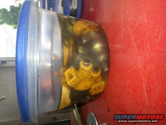

Next thing you can do is to clean the fuel injectors. This is a bit more involved and will take a minimum of 24 hours. You can get an injector rebuild kit from ebay for about $20.
If you follow this thread you can get them working back to new again.
https://www.fullsizebronco.com/forum...-re-build.html

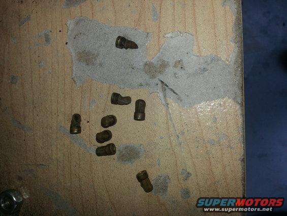

The trick to getting the screen out is to use nuts and a drywall screw. Big nut toward the injector, and smaller spacer nuts.
Put it on the injector just like this. then screw it in. This will eject the dirty old screen.
Now you need a can of B12 Chemtool injector cleaner. Soak the injectors a minimum of 24 hours. It will get very nasty. You can periodically shake the container to agitate them to get the stuff moving thru the injectors.
After the soak, Get your injector harness plug and connect it to the injector. Rig up a 12 volt power source of some kind, drill battery, bunch of flashlight batteries, ect. anyway you can get 12v to it.
Then connect the harness to the injector, connect the battery, this will open the injector. Now spray brake kleen thru the injector filling it up. Using an air compressor blow gun with a rubber tip, set at 40 psi no more no less, blow the brake kleen thru the injector. Do this numerous times. It should produce a dense MIST not streams. Streams indicates its still clogged, mist is what you want. Once they are all done up to this point, put the new screen in and the pintle cap and O rings. They are now ready to re-install.
