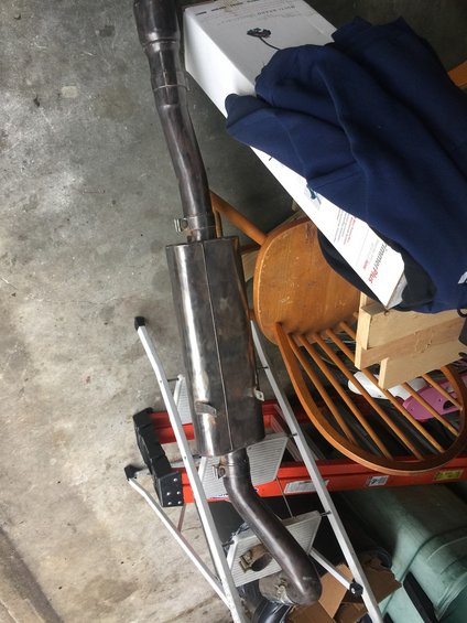

I finished my exhaust which meant replace everything. New bassani stainless y pipe, cat, and muffler, along with tailpipe. I just cut it short of the stock exit. Heres a later picture of some of it from when I cleaned and painted it..

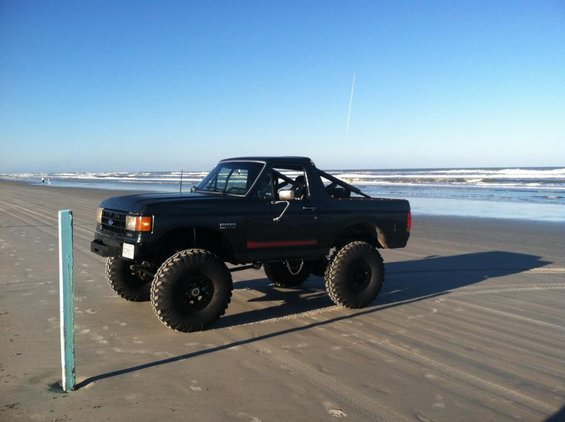

So then we took it onto the beach. I miss living 4 miles from the atlantic ocean..
After that I spray painted the whole thing black and joined some fellow broncos for some wheeling in Florida...

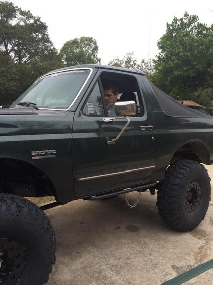

So I met up with some Florida bronco guys to hit some trails.
Driving around the forest.
Taking a break..
Again.
Morning campsite.
Ready to roll out..
