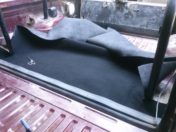

another thing on my never ending list was the interior. i very quickly stripped out the rear carpet and installed a cheap anti-fatigue mat.
you can see the roll cage was still bare metal.
when i pulled the carpet, i found the build sheet. it was in bad shape, but i wanted to preserve it. i took it to staples or office depot or wherever and had it laminated.
mat installed. this lasted about 2 1/2 years.
here's what it looked like when i removed it a week or two ago. i had wanted to paint the fender wheels and lay down sound deadener, but that's not going to work out right now. regardless, i wanted to get that old mat up and this carpet down.
i grabbed some "UV resistant" outdoor carpet from the home depot. it wasn't the cheapest option but it wasn't expensive. it's a 6' wide roll, so i bought a 5' length. that was a perfect fit. i think it was about $25 with tax. i put down my new carpet right on top of the truck bed.
i first mounted it to the tail gate end. then worked back to the front.
and since i have found all the water leaks, i can finally reinstall the rear paneling. that's been off for probably 1 1/2 to 2 years.

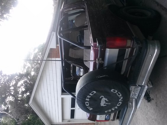

when i got the bronco, there was a very old tire cover on it. so i bought a cheap-o ebay special and installed it. it held on with elastic bungee cord all the way around. that was fine until i was driving down the highway and the damn thing blew off! i bought a replacement and ran paracord through it. now it ties into place.
and a different weekend i set out to fix my broken tailgate handle. the latch was bent pretty badly. but with a little bending and prying, i got it back together. and i had to replace a couple of the retaining clips for the tailgate rods. i couldn't find them easily in the parts stores, but my local ford dealership had them in stock. so it worked out.
i've also a lot of work with my CB. it came with a uniden CB that was ok. but i have since upgraded to a cobra 29 WX NW ST, that has weather band. i wanted that for when i'm camping out in places without cell service. it was peaked and tuned by the shop where i bought it. and i also have a road king mic instead of the factory mic.
here you can see the mounting of my CB originally. that came from the previous owner.
now it sits in a tuffy console that i've bolted to the floor. this thing is on lockdown.

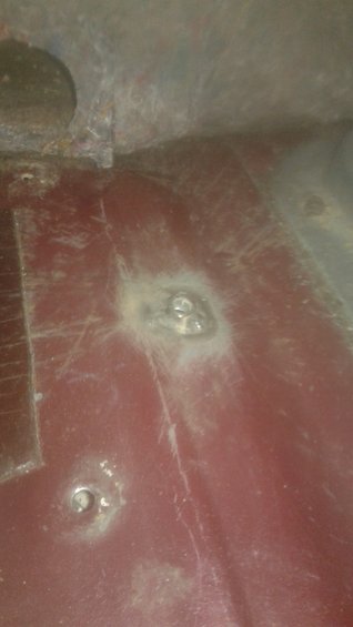

it's hard to tell, but this is the floor board. i (poorly) welded three nuts to the floor. then i ran bolts through the console into the these bolts. no one is breaking into my console. if they take the whole thing, they'll have to break off the three nuts.
opened up:

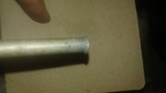

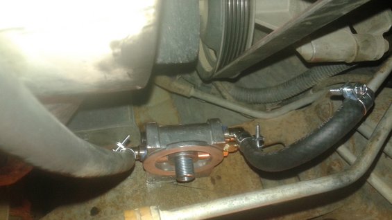

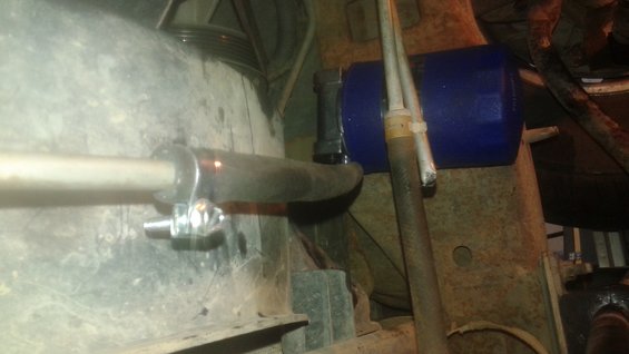

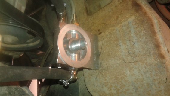

a small project i did was adding a remote transmission filter. i wanted to do it for a couple reasons:
1) increased filtering capability
2) adding a temp sensor for the trans fluid
i wanted to test the fluid temp at the exit of the transmission so i know the hottest temp possible. i went through a few different filter kits and settled on this one. it was pretty straight forward, once i found the right filter mount. i eventually installed a proper wix hydraulic filter (not pictured).
and i'll note this as well...when i had to get my transmission rebuilt, the external filter was full of metal. so i was pleased to know it was doing its job...and keeping the cooler free of debris!
these are right angle connectors and they worked great.
my biggest installation challenge was getting the thing attached to my frame. i wanted it high enough to clear any rocks while off roading and far forward enough to avoid the front sway in normal use. what i finally ended up doing was running the bolts sticking inside out from the frame.
i bought a nice pliers-style flaring tool. it's general tools #152G.
other than that, it was just a matter of connecting everything.
the last thing i did was a partial fluid swap in prep for a full on filter change.
