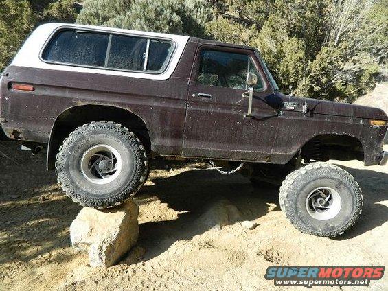

I continued to build it and wheel it like for a while so here are some pics for a trail called Rattle Snake
Getting flexy

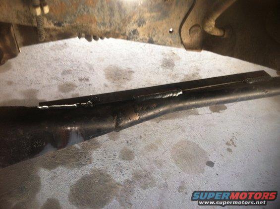

Found out the stock springs weren’t too happy about being stuffed to full compression with spacers under them
Also found the stock steering linkage to be a bit on the weak side, as well as my radius arms that I had extended using the wrong tubing
It was around this time that I had been watching some older Bronco Safari videos on youtube, and they got me thinking. While not a single video showed a fullsize Bronco there, I saw nowhere it said fullsizes were excluded. And I had been looking at the calendar and realized it had been nearly 5 years since I had taken a day off work or gone on a vacation. So the decision was made to throw a few hundred more dollars at the Bronco to get it Moab ready, and we were gonna crash their Moab party with the ugliest, cheapest Bronco they have ever seen
The tie rod was straightened and then sleeved with whatever pipe I could find lying around that fit over the tie rod
The bent radius arm was also straightened and then a piece of c channel welded across the back to try and keep it from happening again
Threw a set of Superlift 4” Early Bronco coils under. While the Superlift coils are a bit stiff in an Early Bronco, they are nice and soft and flexy for a TTB in a fullsize
Then I picked up a set of the cheapest 5.14’s I could find on ebay, NASCAR used take outs, and 5.13’s for the d44. Also picked up the cheapest 3.92 and up carrier for the 44 I could find, which happened to be an Auburn gear clutch style posi, and welded the diff on the 9”
Total cost so far-$1639.33

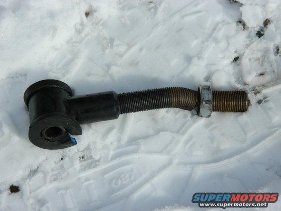

Broke the track bar bushing this day, that sucked
Luckily had a heim with me, got us home

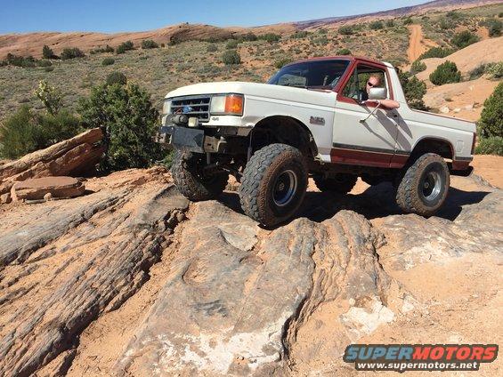

Bronco Safari 2015!!!
So last minute I had a buddy get a hold of me, he wanted to go with us to Moab but had no time or money to put together his own rig, so I offered up my fullsize as a loaner for him to use, and took my wife’s B2 along for us to use.
Our group of friends was off to crash Bronco Safari with my FSB, my wife’s B2, my buddy Tyler’s FSB(which I encouraged him to find and build when this whole Bronco Safari thing came to mind), and our other buddy with his Toyota
This first year we ran all the easy trails, “the basics” that you should probably run your first time in Moab to get acclimated to wheeling out there. Fins and Things, Hell’s Revenge, Moab Rim, and Kane Creek. On all of these easy trails every rig in our group performed flawlessly

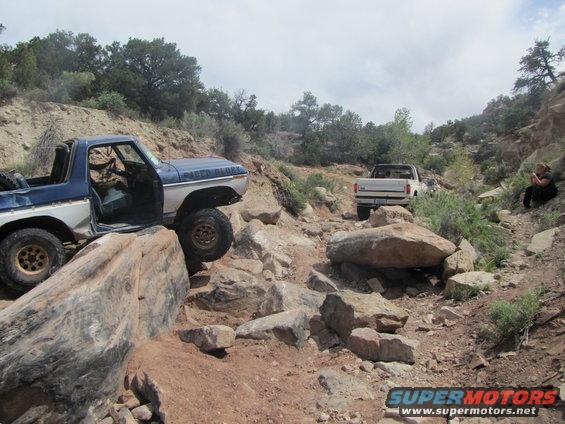

Toward the end of the week we got brave and went to play in Area BFE and on Rusty Nail, so I kicked my buddy out of my fullsize so I could leave the wife’s B2 at camp, and we headed out to make some carnage
My buddy Tyler broke a front shaft in BFE, and on Rusty Nail he had some vapor locking issues, and I lost a fuel pump
Right here on the first real obstacle of Rusty Nail is where the fuel pump died
Luckily I brought a cheap electric pump we were able to zip tie to the frame and get back to camp

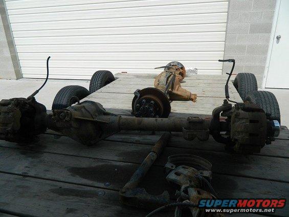

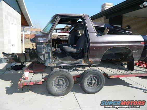

I had a bunch of pics from the next phase of the Bronco on Imageshack which I can't retrieve so that part will just have to be skipped, but basically I bought a 94 Suburban diesel so I decided to make a restomod project out of the Bronco.

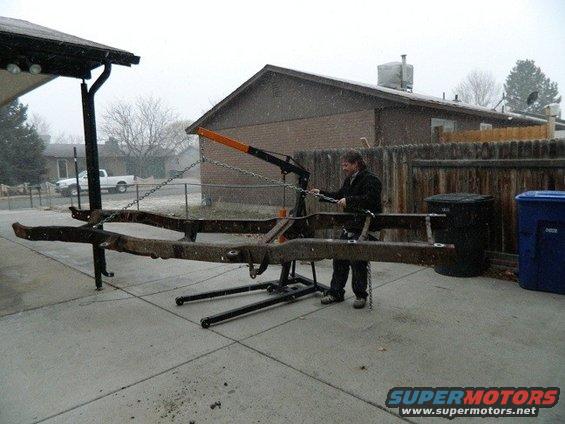

I started by tearing it down and pulling all of the good usable parts from it.
Off to the scrapper!

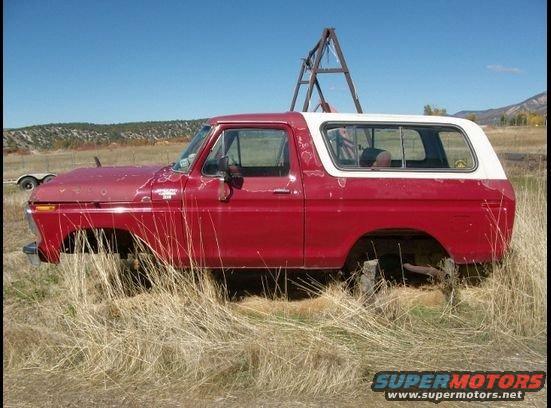

Bought a 79 body and frame for $400. The body was okay but the frame was in much better shape than my 78 was

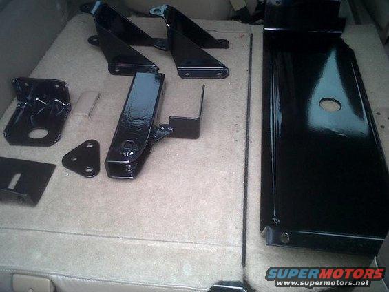

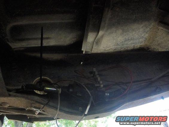

First thing once I was home from Moab was to do something about the departure angle. The trailer hitch did an excellent job of protecting the fuel tank, but it also drug over absolutely everything.
With my 2” body lift, I had 2” I could move the fuel tank up. So I sectioned 2” out of the factory fuel tank skid plate, which also holds up the tank, then made some hillbilly 2” extensions for the top straps
Then using steel from a workbench I had, but didn’t have room to use in the 1 car garage I was working out of at the time, I built a new skid plate
Oh, and I picked up a new mechanical fuel pump to replace the one that died in Moab
