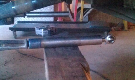

To install the tre and drag link I had to use a reamer which was fun.
