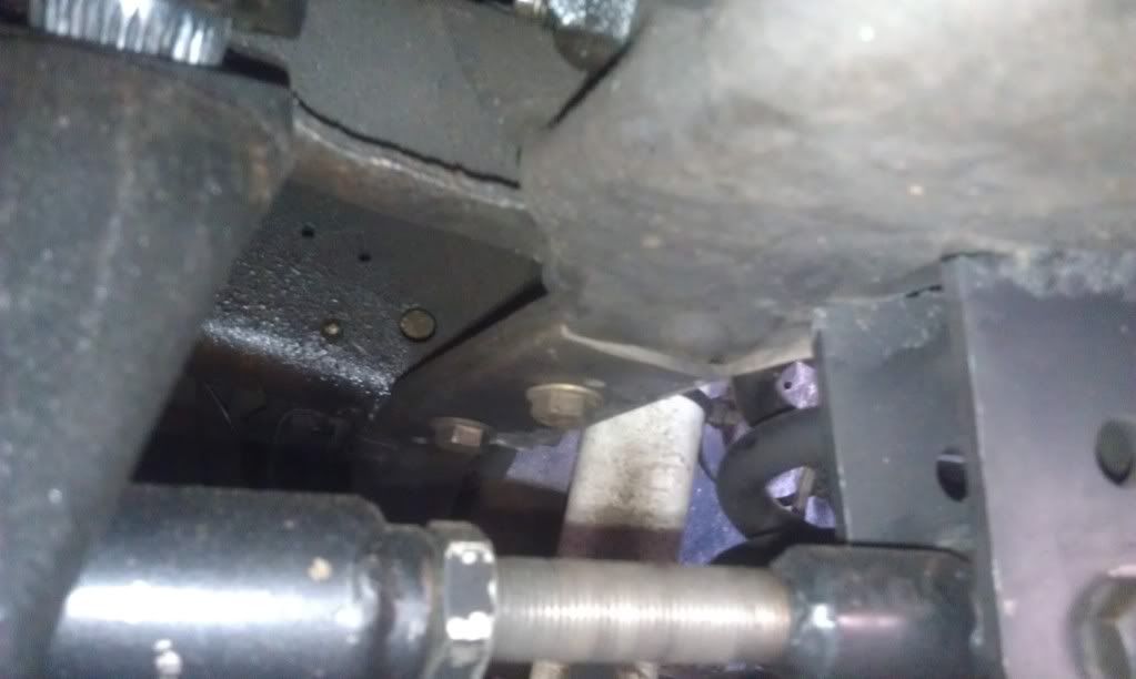

I had a few new questions in a pm so I thought that I would answer them and post the answers on here for everyone.
1. What is your compressed front coil measurement. From where they mount in the upper buckets to the retainer on the axle.
A: About 17"
2. Is your upper buckets moved up the frame or are they flush with the bottom. (I believe there is a lip on them that would have to be cut off to move them up.) I am also not talking moving them forward.
A: I had to cut that lip just a little bit on the drivers side but the majority of it is still there and it is flush with the frame.
3. What is the height of the coil buckets.
A: from the ground to the very top of the buckets is about 38 1/2 inches.
4. Can you get me a measurement from the ground to the center of the front Wheel openings or any other point on the body that I can reference off mine.
A: Not exactly sure what you want here so I'm just going to give you some pics of what I think you want. that way I don't have to explain anything.

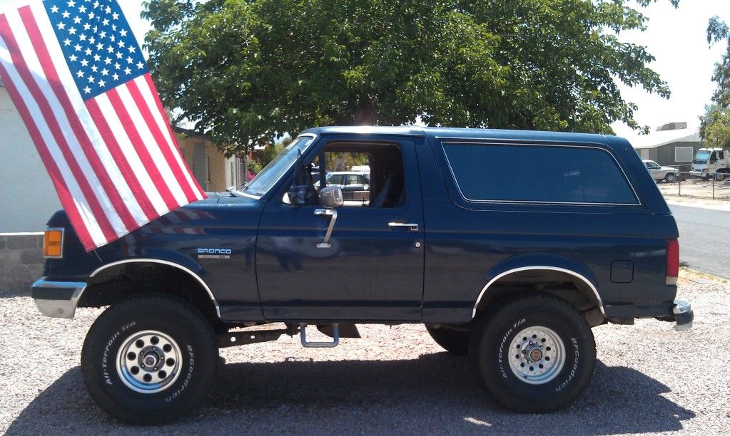

No it actually lowered the front end by about an inch which worked out perfectly. For some reason the 6" lift that I put on the truck had the rear end a little bit lower than the front. I called the company about it and they tried to tell me that that is how it is supposed to be. So when I did the SAS I was hopping that it would lower the front a little to level it out, and it did. Here is a pic of my truck before the SAS, you can see the the front end is just a little bit higher than the rear.
Before SAS
After SAS
