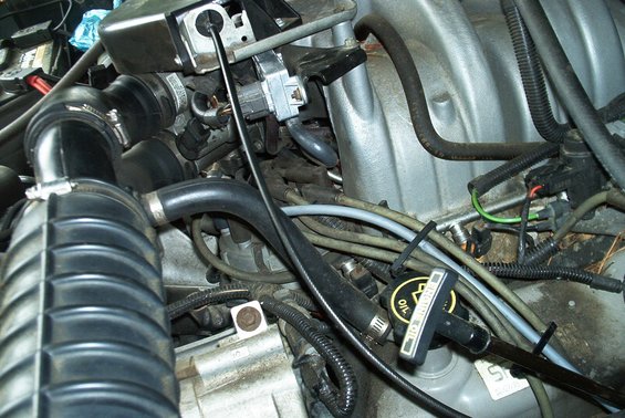

Differential Pressure Feedback (DPFE) Location pic in a 96 5.0; Silver Rectangular item, driver's side next to distributor - MIESK5 NOTE: only 95 5.8L California models & all 96 have the DPFE Sensor instead of EGR Valve Position Sensor (EVP)
96 5.0 Plug Wire Routing on Driver's Side

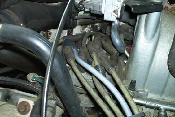

96 5.0 Plug Wire Routing on Driver's Side low

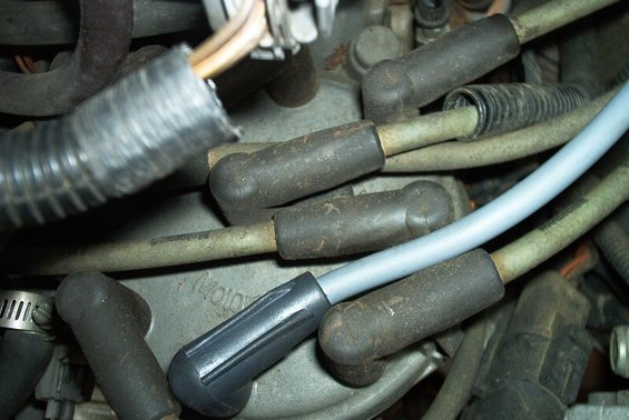

96 5.0 Plug Wire Routing - distributor view
