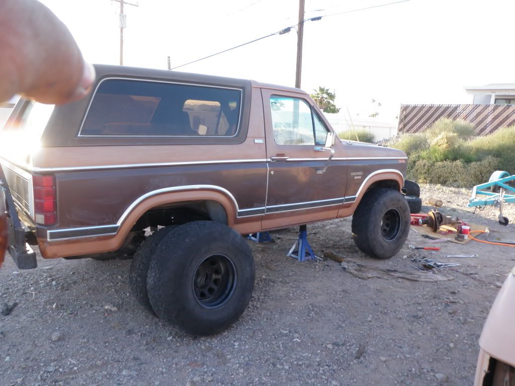

Lift got a jumpstart about a month ago, I sold my Baja Bug that I never was able to take out, right when this showed up on Craigslist
1500 came with these bumpers
a Ranch 4 inch lift with SS brake lines and superlift leafs, 4.10 gears, ARB lockers front and rear, and one of those summit racing cages
So far I swapped over the rear suspension, that was pretty cut and dry. Unhook brakes and ARB line, unbolt axle, pull axle clean it, pull leafs, hardest part was replacing the bushings on my shackles, bolt it back together
New leafs under my 82
clean 8.8 with ARB and 4.10 guts
back on the ground ala stink bug look

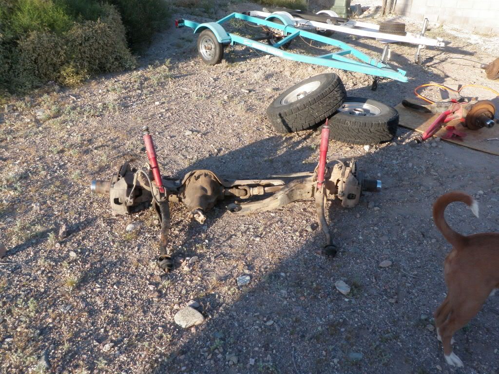

The fun part is swapping the front end over

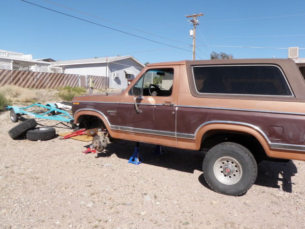

So I began by removing the wheels, springs, and brake calipers from the donor truck
Then used lots of penetrating fluid so I could actually unbolt the front end
have I mentioned I LOVE working in the dirt because after the lift the bronco won't fit into the carport.

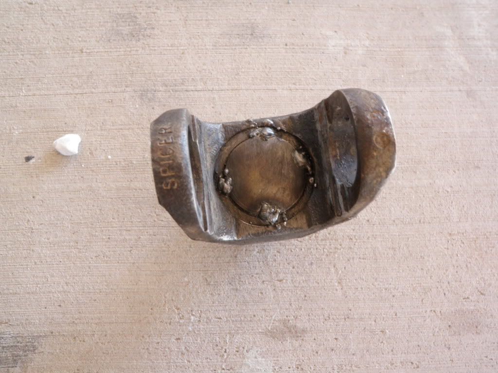

So this front end already had the spring mod done to the midshaft, but the cap came loose.
I had the U-joint pulled, gonna tack weld the cap in today, just gotta source some new spicer joints for the axle. More pics as I work on it, but juggling 4 upper level college classes online takes a fair amount of my time.

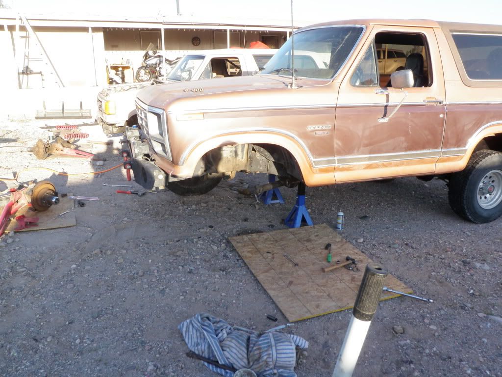

Spent another 2 hours on it today.
Cleaned up and tacked the washer into the slipjoint today
I'm not the best welder, but this will hold, I tapped on it pretty good with a punch to make sure

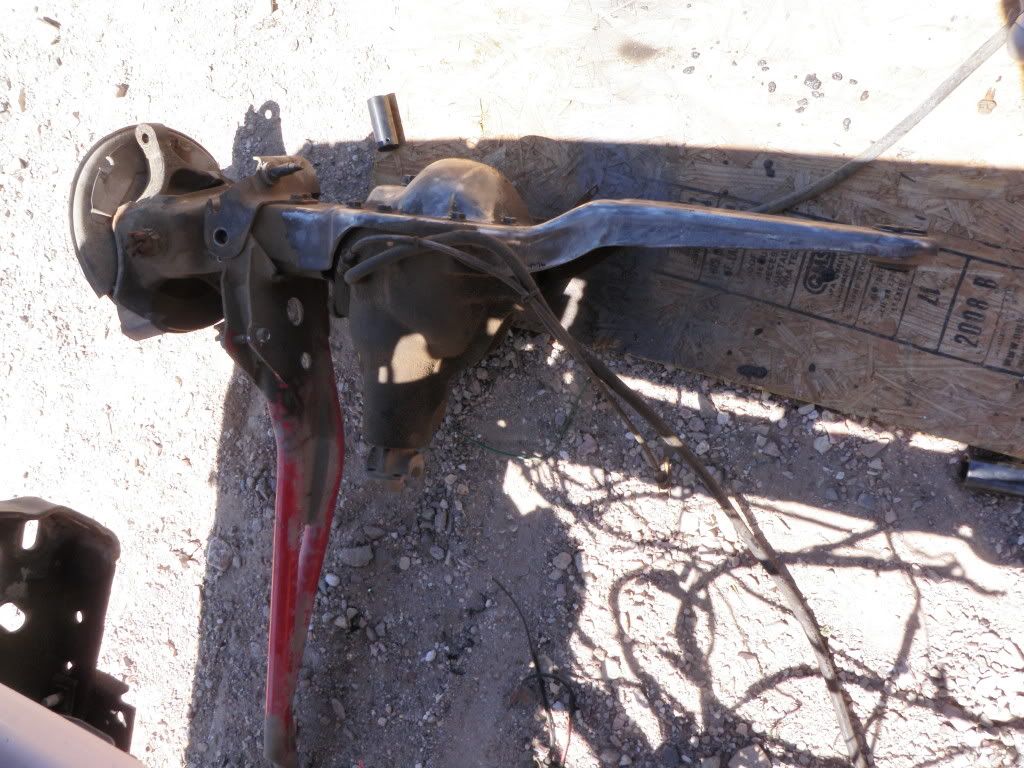

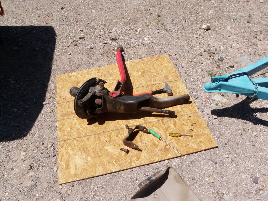

pulled and cleaned up the radius arm brackets, just gonna swap over the ones from the parts truck since they were already cut off
I pulled the steering box off the parts bronco, just in case, it is filthy but should be ok as a spare if I need it later. Then pulled the parts bronco off the jackstands as I won't be under it again, so it is now only on blocks.
After placing mine on jackstands I began unbolting my front end, so far all I've pulled are the brake lines, front driveshaft and sprayed the snot outta the other bolts with PB blaster to get them more easily motivated to come off.

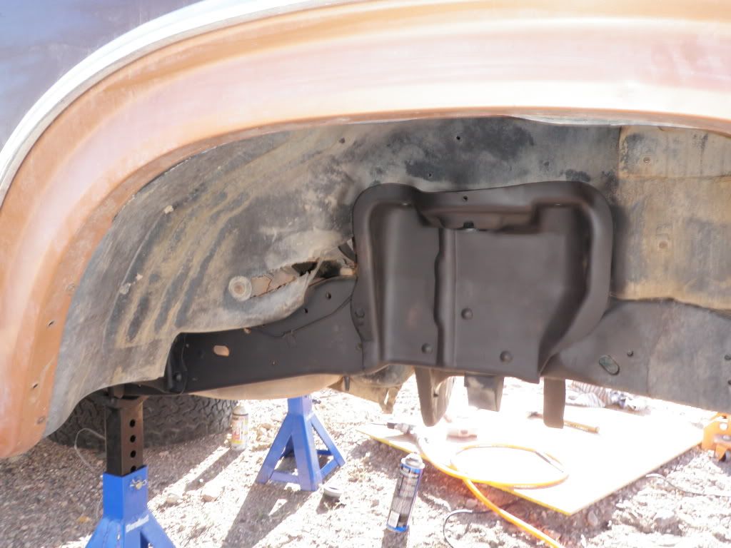

Looking good bro. If it were me I'd support the truck by the front frame rails but it looks as though you don't have a long enough set of stands so oh well.
BB33's is offline

I don't have a long enough set of jack stands for the front frame, otherwise i would.

Easy part was to unbolt/remove shocks, brake lines, axle vent, front driveshaft, then unbolt the upper spring bracket, and lower spring nut.
the trick on the lower spring nut, is drop a 1 1/8 deep socket in from the top, then put the ratchet on it after the socket is in the hole, should come loose without too much fight and remove the spring and pads.
After that, comes the fun part.
Soak EVERYTHING with penetrant for a day or more, then pull the 1 1/8 bolts off the radius arms, then the two pivot bolts on the crossmember.
after that, I used a crow bar to assist the beams from coming out of the grooves they are in. Not a ton of help was needed, just had to help gravity out a bit.
then lift/slide forward to get the radius arms out of the holes they are in. The neighbor helped with this, as the threads were wanting to hang up on the brackets.

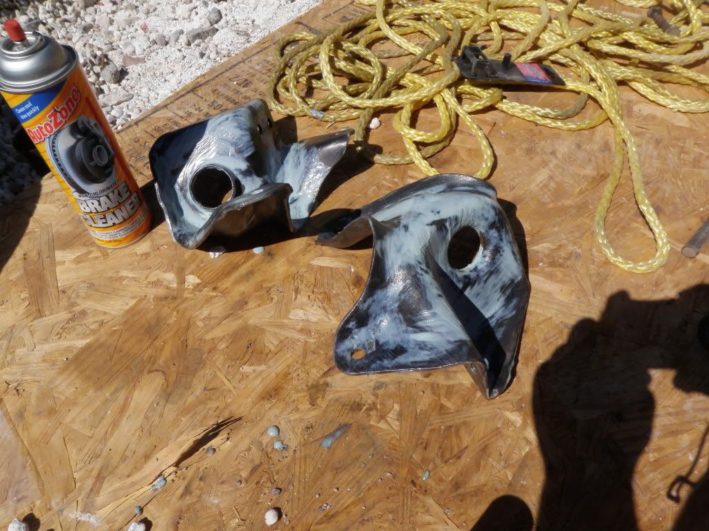

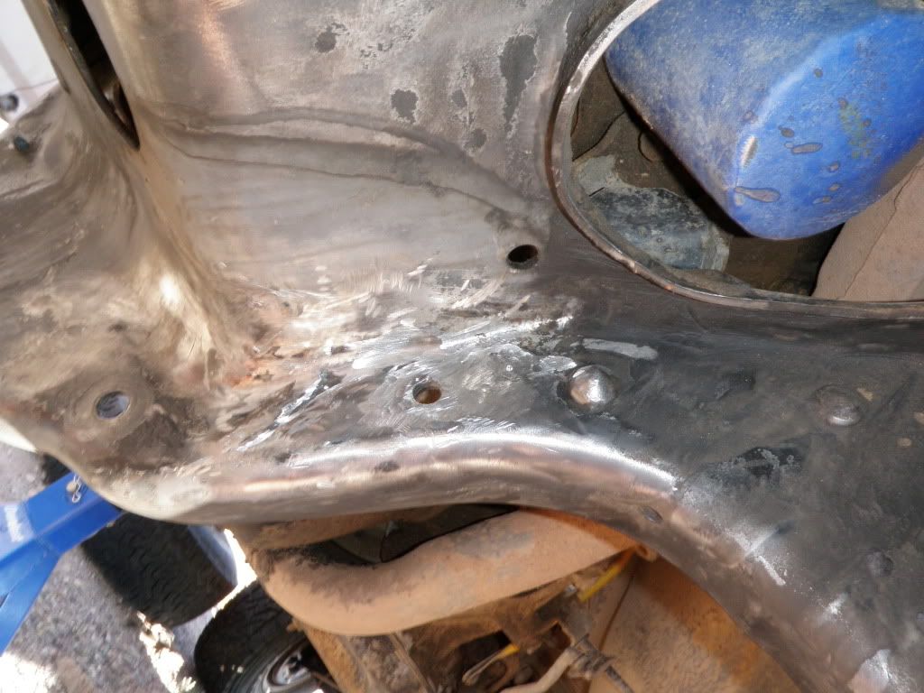

did some more work today, dosn't look like much, but man I'm glad I had earplugs. My arms have lots of little red spots though, probably shoulda worn long sleeves.
I cut off the rivets for the stock radius arm brackets so I can move them back for the rancho long arms.
Then cleaned and hit the passenger side with rust converter before I seal it up tomorrow with some good ol rustolium.
Had to cut off a bracket on the drivers side that took a bit of work, then a few more rivets for the Rancho brackets, got to the last one, and I'm stuck, got the head off the rivet, but can't punch it out yet.
unless someone has a better idea, I'm gonna take a drill to it tomorrow. I tried a ballpien hammer, a punch, air chisel etc.
all that time holding up the angle grinder with the wirewheel and cutoff wheels on it has my arms sore, I'm gonna sleep good tonight. I got to play extra long today because I got up and got a lot of homework done early today, lets hope I can continue this trend.
navynuke is offline

For those rivets you can just cut an X in them with the grinder and then punch em out easy with the pneumatic chisel! Looking good man. I'm finally starting my SAS and got my front cross-member mounted today! Keep up the good work!
