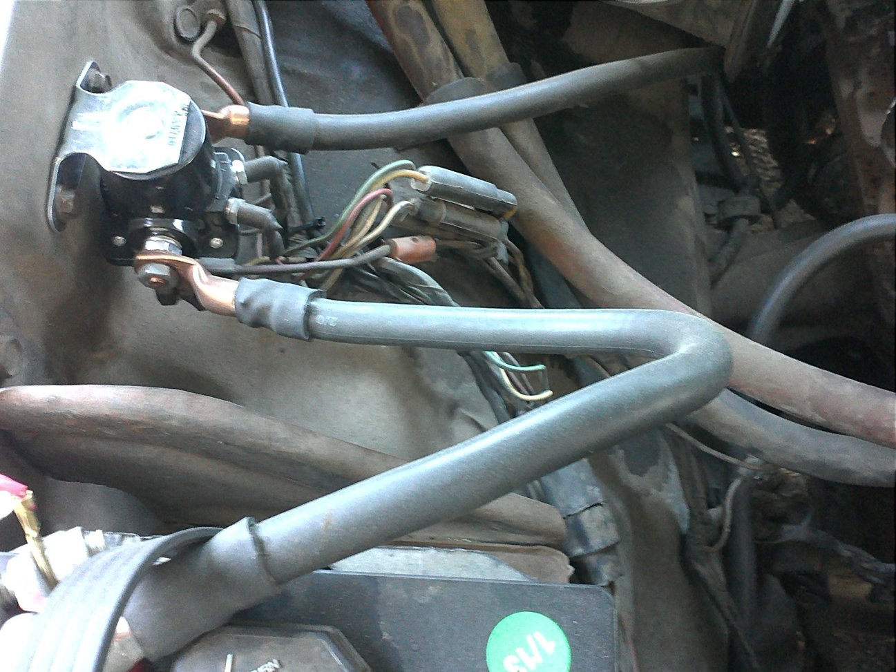

Starter installed, inspection cover installed, new starter wire ran. I used 1/0 guage car audio cable for it this time in prep for the higher compression 429 that will end up in the 78 soon (hopefully). Had to order some fittings and 15' of AN line for to finish up the trans coolers and a new set of remflex collector gaskets. Should have those items tomorrow.

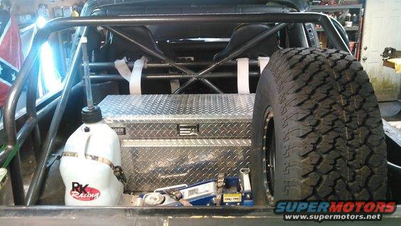

In a case of a bit of mission creep I have decided to move my spare from standing upright on the passenger side rear to sitting on the floor somewhat slightly towards the driver side.
Here is as it sits today
Doing this maybe just for something different, but I think it will better center the weight, especially when the gas cans are on the back bumper (they are on the pass. side). I also like the idea of being able to do a shelve on top of the tire, much like Desolate has on their shop truck's rear setup.

Hey, you can never go too big on a starter cable. I have 2/0 battery and starter cables on my stock 302 in my F100. I just never wanted to have to worry about resistance. I noticed a huge increase in starter cranking speed once I swapped out the old, relatively tiny, cables. They were melted from over-cranking as well, which I'm sure didn't help anything.

Agree especially on off road trucks where stuff happens and you end up having to re-fire it sitting in mud, hot engine, etc...
I have already swapped in a PMGR sytle starter as well from LEB, that has thus far proven to be a good piece.

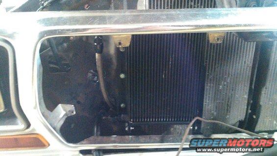

AN hose and conections work great, be hard for me to use much else. Made new lines from trans to front cooler, then from that cooler back to the rear cooler, lines I had made previously. Knowing I may add another cooler I had added in a couple unions earlier so this was easy to do. I also had those in place if/when I wanted to move the trans temp probe around.
-8AN right from trans out threw out the whole thing
