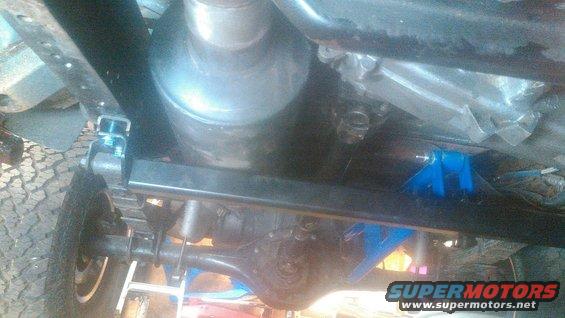

The most correct way to mount this is with the antiwrap bar end above the frame side mount, so the shackle is always in tension. I agree 100% with that, it was an oversight on my original install. Not wanting to change the brackets and such, this was an OK solution for now. I would need complete new bar and axle mounts, and cross-member to change it again. Long term goal but for now this is better then what I had. Everything is loosely bolted in mine in that pic, it needs adjusted for a better angle.
EDIT:: To the above point the Duff bar on the 92 bronco is mounted as so the frame side mount is lower. This is a better approach
I have seen the other style of bar you are describing, but none of them looked like they would last long in the mud to me, however all the ones I have seen like that where on street applications too as in I have not yet seen a more offroad oriented one.
... As a side note, you should post your build sometime so we can all pick it apart ( I mean that in the best way possible, its fine your asking these questions on mine) Discussion is good

Finished up the bar install, works just like my old one only this one does not make noise. Right or wrong on how its working.

Anti-wrap bar works great, have not had any issues with the new front setup. Makes no noise as compared to all kinds with the old shackle and rod ends.
