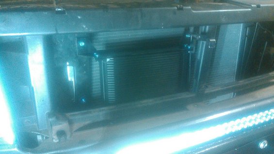

Somewhat related, I finished up the install of a new trans cooler last night.
9"x11"x2" (thick) core about double what I had on there previously.
Just to add some more info for anyone else looking, Animal Performance left at least 1 bolt lose on the valve body, and also did not use the correct length bolt on the servo either as it was not tight against the servo cover. The kickdown linkage I feel was also installed incorrect and as such broke when I went to move the gear selector for the first time. I could have bumped this during install, but I have never had one get in a bind from that. Usually they just end up not hitting the kickdown pin on the inside of trans. I feel that maybe this is broken/bent now internally and keeping the trans in a "floored" state. Though when I had pan off I was able to cycle it what I thought was completely.

I agree good shop, His manual valve body you can ditch the governor and the modulator valve too. Like you said true manual.
Since waiting on my valve body had time to mess with the 78.
H57 vs H58 Deaver Springs
h57's
H58's, I am not sure why it looks like it is so tall in the rear in this pic, it is just like below.
Little better picture
From my measurements I ended up about 2" to 2 1/2" higher in the rear then I was. I put the stock block back in as so I could move it around yard. From before that was about 1/2" of lift with the wedge. With the wedge out I should end up with 1/2" rake with all my gear in the truck, 1" in normal street things in it. They should settle a bit after some use so I think I am about perfect now, turned out exactly how I wanted
