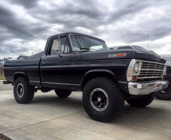

Not alot of updates on the Bronco unfortunately, between getting ready for our second kid and working 12's I haven't had as much time as I would like to work on it. However, this 1968 F100 4x4 short-bed popped up for way too cheap and I jumped on it with the intentions of flipping it.
My Dad has been looking to sell his Bronco to fund his 68 fastback build, so instead of selling it to some stranger I offered my F100 in trade. He agreed, however he'll be keeping his motor for the Mustang. So, that left me to find a motor. I picked up this 429ci motor locally and am currently going through it and cleaning it up.

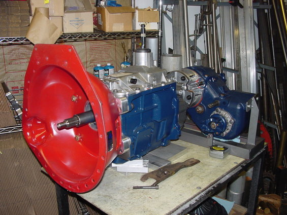

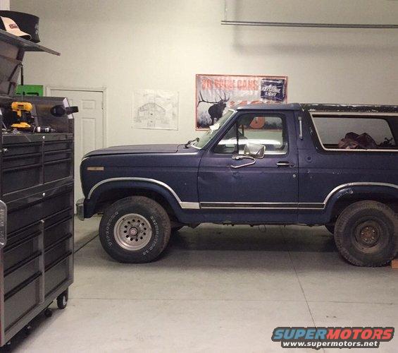

Here's my Dads Bronco I'm trading for:
Nv4500 w/ custom adapters, Np205 twin stick, trussed D44 w/selectable detroit locker, trussed 9" with Nascar Nodular 3rd, spool, 35 spline chromo axles etc.
