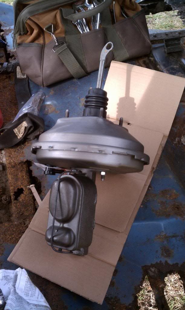

Okay I was back at it again today. Unfortunetaly progress was not really made. I was trying to finish up the brakes. One of the first things I did on this thing was to replace the lines and rear brakes. I left the booster/mc and the front calipers and rotors alone. Mark and I tried bleeding them last week and the pedal was horrible. So I went to the NAPA store and ordered a new one. Booster/mc was for a 79 because thats what I have right? So I pulled the booster/mc today. Not to bad getting it off. Now removing the pin that holds the pedal actuator and the plunger. That was a different story. It seems that it really didn't want to leave the other. Rust is a bitch let me tell ya. So I went to the other project Bronco and stole it's mounting bracket and go to hook it up. Well the plunger on the new booster/mc is totally different from what I just pulled off. Seems Ford switched the booster in 79 and went to a different style. Well I guess they had a few of the 78 style left on the assembly line and gave my 79 one of them. So now I have to wait for the new 78 style to get here from WV.
Pics
Old Booster/MC
New 79 Booster, the 78 doesn't have that curvature.
I will back at the cutting tomorrow while I wait on the new metal to get here.

I feel your pain as I went through the same issue with the brake assembly on mine.
One suggestion is not to buy a rebuilt master cylinder, just get a new one from Napa, that rebuilt one cause me to have soft brakes and it was ticking me off. I put that new cylinder on and it was night and day! Now the bronco can lock up the 35" with no issue!!!
I got it out and was like WTF that ain't gonna work. I'll keep that MC issue in mind Cody thanks.

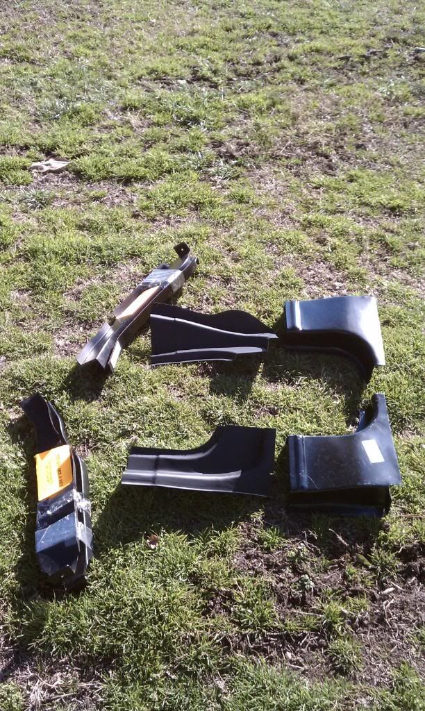

Today I got a few things to get me going at it again. With the weather we have ahead of us I should get moving again real soon.
My goodies!

Jealous!!! I want a real welder, dammit! Haha
That's a great looking pile there, Rick. Funny how we can actually get happy looking at a few bits of formed metal laying in the yard, huh?
Funny it is, ups guy and I know each other by 1st names. Got a good welder, lets see what I can do w/ it.
