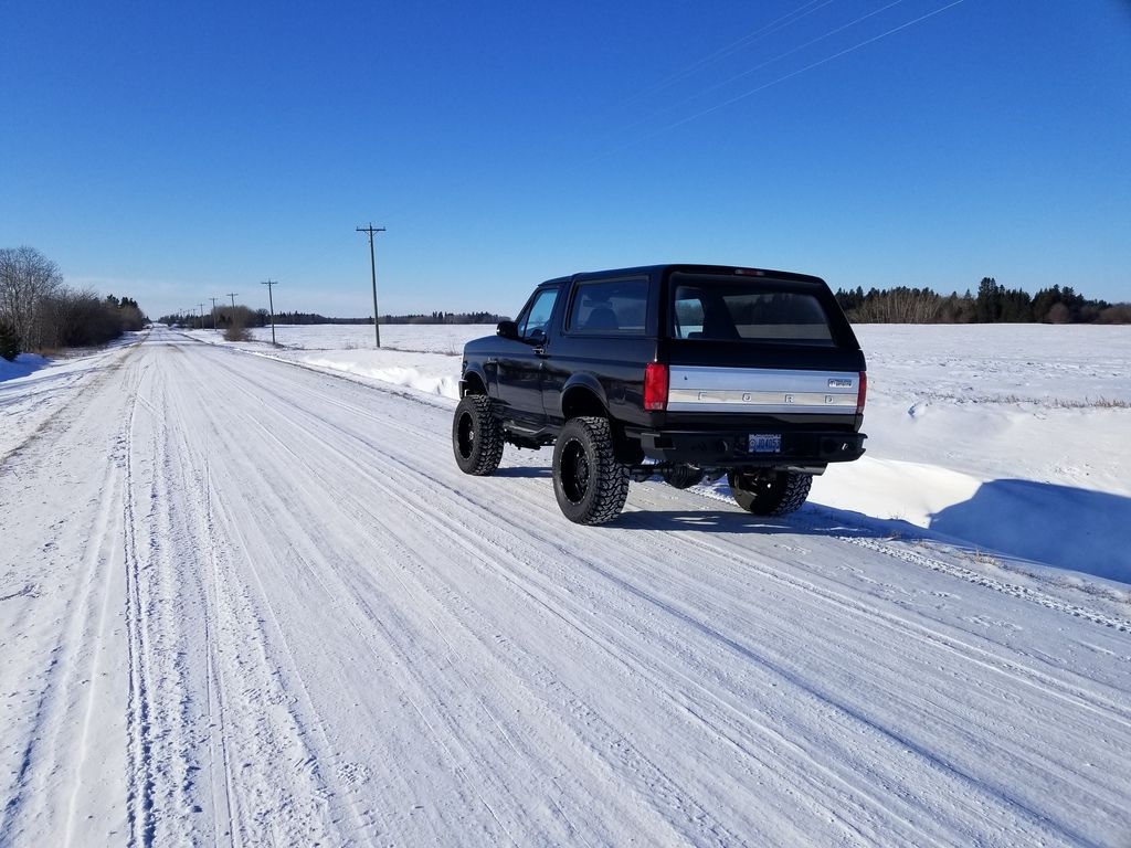

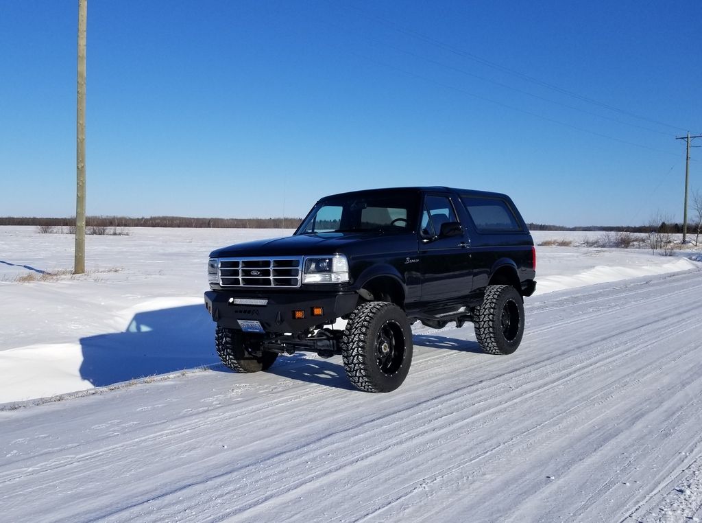

Sneak peek of the interior. The truck is currently at the upholstery shop getting the carpet steam fitted and the seats installed. Very happy with the color choice and design - definitely looks different in person.
I haven't driven the truck all last year and I was reminded of a couple things on the drive back from the lake:
Rebuilt transmission still leaks, the 08 cruise control buttons an electronics ship rewired for the wheel don't work, the seatbelts that were color changed don't retract, the exhaust still rubs, and after the reburn I still don't like the transmission shift points or the swamps tunes or a combination of both... I still prefer the stock tune. I also thought I would be able to try out the new Warn hubs and have 4x4 for the first time but the driveshaft shop built the yoke end with the wrong u-joint.
... But its still coming along. And after getting some more reworks done (hopefully without paying again), the stripe, and alarm/command start I should finally be pretty much done and able to enjoy it.

Those seats are freaking beautiful. Where did you get the idea for the skeletal bronco logo?

Bronco looks incredible!
