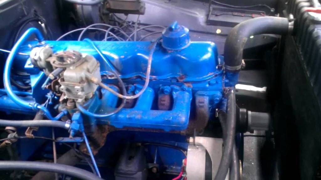

Positive Crankcase Ventilation. It consists (on my 81 300 six anyway) of a vacuum line from the manifold that runs to the PCV valve on the rear of the valve cover. This pulls vacuum through the oil breather cap on the front of the valve cover (that you remove to add oil) which has a hose that runs to the air cleaner housing where it connects to a filter.
PCV valves can stick closed, or it may not be hooked up at all. Without the vacuum it provides, there may be pressure buildup in the motor, causing it to push oil out of weak gaskets and seals. May not be the case, but something to check.

Mine doesn't show good with the air cleaner on it. Here's one I swiped off the net. It's an earlier version, but I think it will give you an idea what to look for. Where the blue hose comes off the top left side of the valve cover is where the PCV valve is. This one is straight metal where mine and probably yours is a plastic 90 degree ell (mine has a smaller connection also). You can see where it ties into the manifold for vacuum. On the other end of the valve cover is the breather cap. You can see the 90 degree fitting on it. That should have a hose connected to it that connects to the breather element in the air cleaner housing. If you have an aftermarket air cleaner, you could use an aftermarket breather cap without the hose connection that has holes on the bottom side where it would draw air in.
It's hard to see, but if you follow the hose from the PCV valve, you can see where mine was originally connected below the carb.
HTH, if not I can take my air cleaner off and get a couple better pics. Or if someone else has some, please share!

I think mine may be all hooked up but I don't know what the PO cut off. Lots of Rigery here. Something went on the air filter to the snorkel too. I haven't seen a stock set up bit I have empty holes and cut wiring everywhere. My brother said I needed a duraspark set up, bit when he saw the truck he said what the PO did was similar. I know the carb is a stock 1 Barrell because I can see the part number on it... who knows really
She runs well.... makes me apprehensive and scared to mess with it
