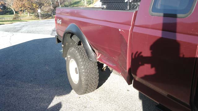

Unfortunately on Friday, someone was thoughtful enough to hit my F250
So now im on the hunt for a new bed. Most likely just going to massage this one and leave it for the winter, then replace it in the spring.
