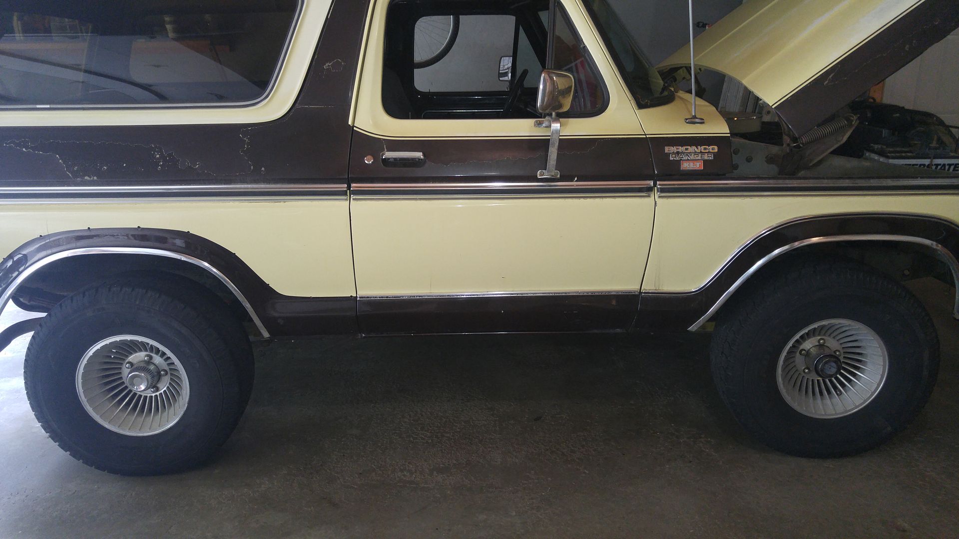

Well I thought I'd give a try at a build thread for my new project the 79 ARIZONA.
I picked it up a few months ago and have started to make it mine, just now have the time to sit and upload pics and post since winter is here.

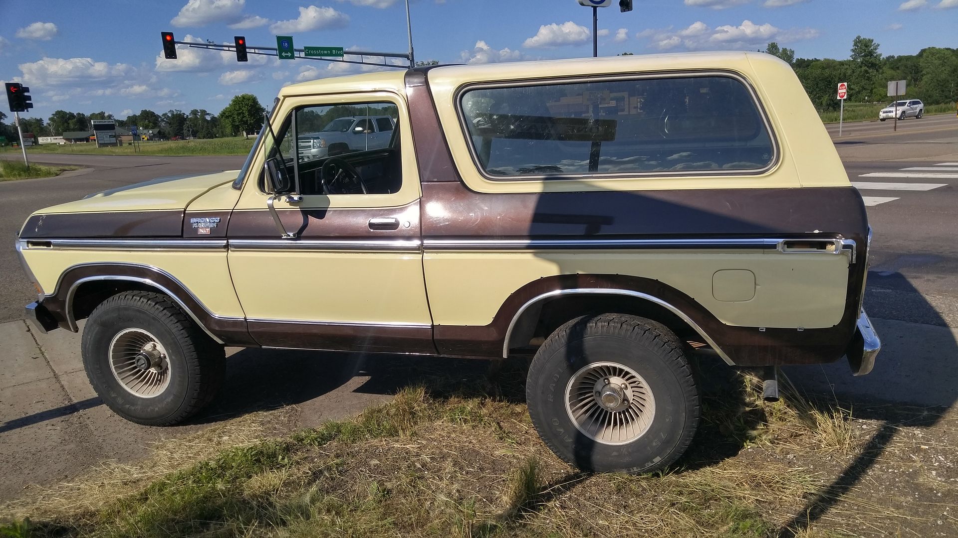

This is what I started with( didn't quite make the 50 mile drive home)
1979 Bronco Ranger XLT

The interior is going to get major redo. The seats are new Tahoe rear seats and somebody paint the nice brown doors and dash a crappy job of black.

I was about 5 miles from home and it died at a stop light, timing was too advanced and it wouldn't restart while hot. I figured that out after it was towed home..

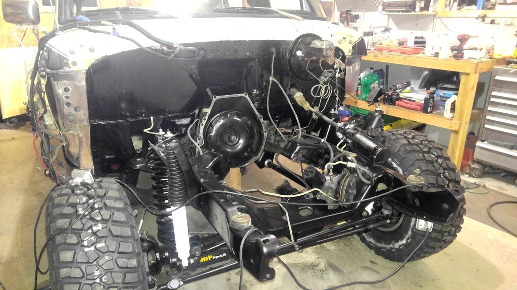

This is about where it sits as of today, rebuilding a 400 with .040 TMeyer pistons EX262 comp cam and mild porting of the heads.
Rewiring the whole thing with American Autowire kit also.
Already done: front end bushings, bearings, spindles, u joints, tie rods, and ball joints.
