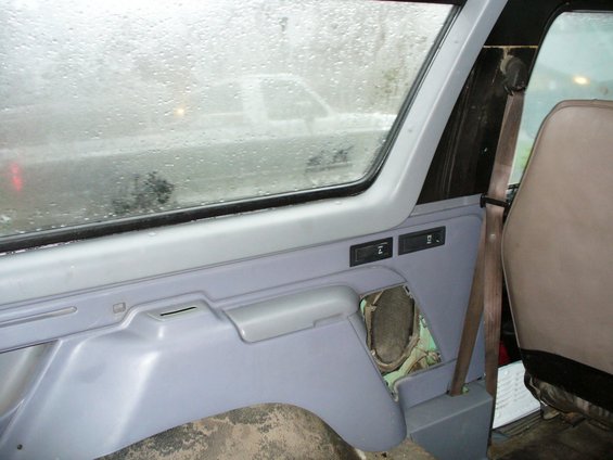

I realized I probably should have grabbed, or at least paid attention to, the rear speaker cages at the junkyard. I'm thinking mine don't line up quite right with the side panels now.

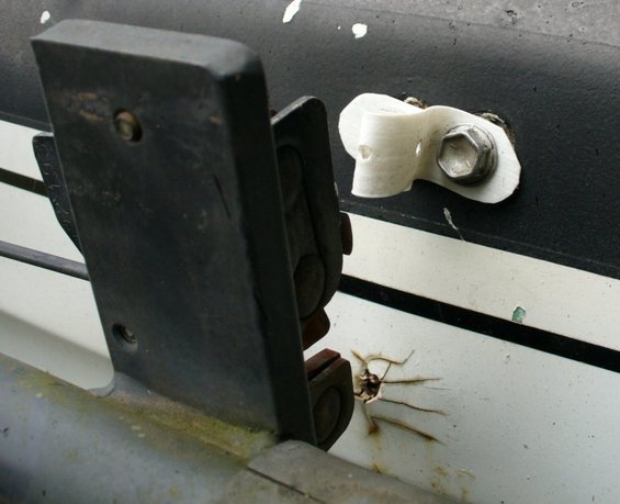

Awesome, thanks. Ah, the tail light... Maybe that's what I did at the other yard when I was able to look in there and see the bracket, not from within the cargo area like I was thinking.
The bondo actually wasn't nearly as tough to get out as expected. I used a center punch to poke the middle and pop most of the chunks out, then a combination of the punch and a phillips screwdriver to work the rest out of the threaded section. I followed that with a wire brush and then threading a bolt in and out a couple times.
I'll probably have to buy a new catch (#F2TZ1469A) for the tailgate, since the guy I bought the carrier from sold the whole tailgate to someone else previously. I doubt I'll luck out and find someone willing to sell just the catch unless I run across one at the junkyard, but at least they're only $40-50 new.

I remembered the "work smarter" mantra and punched the broken drill bit through instead of trying to extract it. That side of the XLT interior is pretty much done.
I haven't decided yet if I'll install the trim up the B-pillar, over the door, down the A-pillar and across the windshield header. I sort of like it blue-ish in back and black up front. One thing I don't care for with the Bronco interiors is they're just one solid color (at least all the ones I've looked at). Dash, seats, carpet, headliner, panels and trim... I'll definitely paint the tan horizontal dash inserts once I settle on colors. I like the silver of the XLT trim.

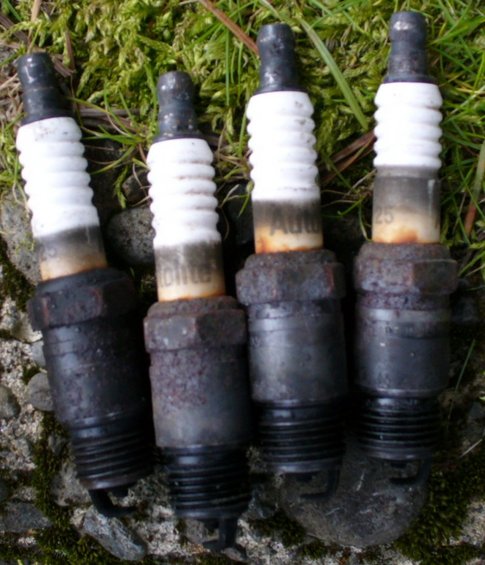

FedEx package #1 arrived after lunch, so I got to work on changing out the spark plugs. It's nice not having to disassemble a bunch of intake and valve cover stuff to get to them, but boy is access limited in spots with header heat shields and what not. The old ones weren't looking so good...
I had planned on popping the old wires back on so I can fire it up today or tomorrow, but the boots were crazy hard to get off even with a puller, and one of them started tearing at the elbow. I question whether I can get them off again if I reuse them. Ten days to get the new spark plug wires is agony. :(

Here's what I came up with for a temporary tailgate latch for the spare tire carrier, until getting a proper one:
It's obviously insufficient for holding a wheel/tire in place, but I wanted something I could bungee or zip tie the carrier to while [hopefully] driving it this week, keeping the carrier from swinging open.

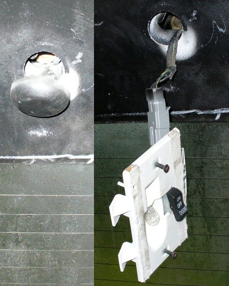

I decided to work on something far removed from the engine, running a new dome light wire bundle from a '93 F150. My driver's door plunger had one wire corroded off and one partially soldered back on, and one of the wires in the connector up to the dome light were severed. How it still worked with the passenger door open is beyond me.
Side note: To my surprise, the models with dome-only and with dome/map lights have the same two wires. I assumed there would be a 3rd wire, with one being always hot (for the map lights) and one being switched by the plungers. I'm guessing one is hot, one is switched, and there's no ground wire -- it's just body ground?
The F150 has the exact same connectors and wire colors, but with two additional wires in the empty slots for the 3rd brake light behind the cab. (There's a hint how to wire up a 3rd brake light for Broncos that are going topless for extended periods.) What I didn't count on was the wire being a few inches shorter than the Bronco's. Is our roof higher? I ended up having to fish the other end of the connector through the little access hole behind the door plunger (driver's plunger is at the back of the door on '92, not the front) and up to the back speaker access hole, which of course meant taking the side panels off again to uncover it. I had spliced the F150's non-corroded connector on with just enough extra wire to reach up that far.
With that plugged back in, I reconnected my dome light and the passenger door triggered it as before. I excitedly checked the driver's door and...nothing. WTH? I even used the F150's better condition plunger. There must be another wire rotted somewhere in the circuit. I feel like it would almost be better at this point to just buy a new wiring harness and start from scratch.

I have no clue... but I'm interested in the outcome. my new2me '95 has similar behavior at the dome an partial disassembly has revealed a few lights that got way too hot, which I'll be replacing soon.
I'd recommend LED bulbs if heat is an issue. You'll probably get better light output, too.
After a dinner break, I decided to attempt ending the night on a good note... I installed one of the chrome dome/map lights to see if my repaired wires would get the map lights working now. Sure enough, I fixed that aspect. That answers the confusion stemming from this old post of Steve83's:
The 3 mounting screws hit your original terminals in the roof perfectly (unless you originally had the cheapo dome with no map lights).
The holes still line up on models that had the cheapo dome. It just uses a different hole for body ground, but they're all there.
So, with that working, I tried out the next step: installing the nicer Mustang light. Happily, that worked too. And yes, it is much, much brighter than the chrome Bronco/F-series one. Now to build a base so it sits flush against the roof, and see about getting some #578 LED bulbs for it.
'92 Bronco Build Thread - '95 MAF 5.0, H5 axle code, York OBA, 3G alt, custom jump seat console, flomaster steps/sliders.
http://www.supermotors.net/28006
fodder is offline
post #40 of 414 (permalink) Old 03-24-2017, 02:12 AM Thread Starter
fodder's Avatar
Join Date: Mar 2017
Location: PNW
Posts: 1,784
Bronco Info: '92 Custom
I forgot about this post: http://www.fullsizebronco.com/forum/718181-post22.html
So yeah, body is ground, black/blue is the door switch, and green/yellow is hot. That makes sense, because my green/yellow wire is the one that was rotted out.
I did my re-wiring in a way that the connectors would be higher up and not sit in pooled water by the seat belt reel. That and I tossed the yellow-insulation-in-a-bag(s) that contributes to water pooling.
