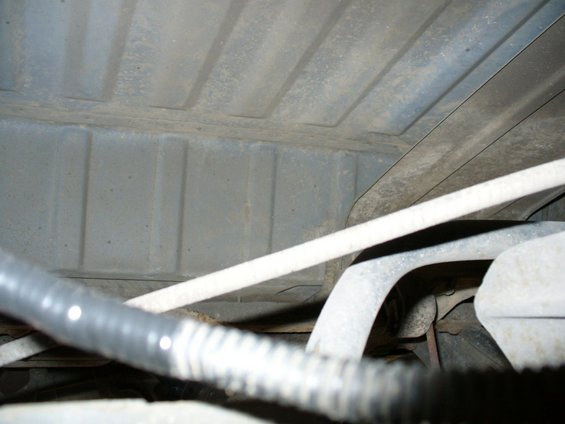

I also snapped a couple pics of the underside of the cargo area, to get an idea of where the hidden compartment cutout would go. It's basically a wide-open empty space that would require building a new floor.
Looking forward over the rear diff.

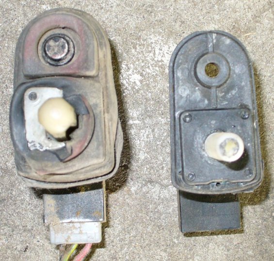

Another driver's door plunger update. I found two of them at the junkyard, one being like the stock cross-bar plunger (left) and the other being a round plunger (right), but with the same connector.
Since I've already determined that my stock one is dead and the replacement of the same style isn't terribly reliable, I figured I'd try the round style first. It worked the first time and every time! Ironically, it wasn't even plugged in to anything in the truck I found it in. It was screwed in place but disconnected in back. It was a F-series, but I don't recall the year and model. The round style is probably less likely to allow gunk in, having no open slots at the corners.

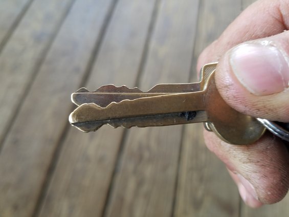

Biggest take-away- I had no idea that the tailgate was supposed to use a different key! I've been hunting for a matching set of 3 forever. My BKO has the tgate and drivers door on the same key, but I have no idea where the key is to the passenger door.
Originally Posted by fodder View Post
Really, you have a matching door/tailgate key? That's confusing... Maybe '79s were different? The door locks are super easy to remove, with just a metal clip that slides out of the door jamb portion, then some wiggling to get the lock cylinder off the actuator rod. You can probably get a locksmith to re-key it for you to match the others.
just fyi, my 87 has a matching driver/passenger/tailgate key, so i have 1 key for all 3 outside locks and 1 key for the ignition. my understanding is that from the factory they came this way, 2 different keys total. this is backed up by the fact that all 3 outside locks use the same key blank (while the ignition key uses a different one), meaning that it is possible to use the same key on all 3 outside locks. if you want to get a matching set for all 3, i would suggest starting with a new set of door locks and good functioning tailgate lock then get a locksmith to rekey the tailgate to the doors.
sorry for the hijack, i had meant to post this when @fodder originally asked about the keys but i got distracted and forgot.

That or your truck has been re-keyed at some point? I picked up a spare '86 door lock last week that I could check against to see if its key way is reversed from mine...but I can't remember where I put it. A smart move would have been storing it with my old lock set. :/

My 88 and both 86s,along with every foxbody stang if I remember right had 2 keys. The blank notches are opposite for inside vs outside keys. I've gotten used to it.
Good thing my first Ford was a '90s model. That would have driven me nuts. More so the lack of logic to it than the actual need to switch keys for entry and starting.

not exactly sure what the logic behind it was but one cool thing is that you can use a hide-a-key on the outside of the vehicle and not have to worry about someone driving off with your bronco. another cool thing is you can come outside on a cold morning and crank up the truck to warm it up then lock it.
im not really sure what to make of what you found in your owners manual, but i'd like to think that on 80-91 models, ford designed them to only use 2 keys. they HAVE to have a different key for the doors/tailgate(same key blank for glove box too? i havent checked this) and the ignition switch (as greasemonger pointed out, they use different key blanks) but i hope they werent dumb enough to use 3 keys, one for ignition, one for doors, and one for the tailgate.
while typing up this post i realized something that may explain why ford used a different key for the tailgate/glove box for 92+ broncos. fodder, you said your bronco uses the same key for the ignition switch and the doors, right? well, on mine and greasmonger's broncos, thats not possible because they keyway is reversed between the ignition and the doors. what it sounds like ford did is they redesigned the door locks for the 92+ broncos and f-series to use the same key for both. my guess is that because the bronco was the only vehicle that would be using the tailgate lock, and since it was so unique of a design, ford didnt want to waste the time redesigning the tailgate lock, so they just reused the old design and gave the customers 2 keys, one for the doors/ignition and one for the tailgate/glove box. i found a parts listing on rock auto that confirms that the 92 broncos use a lock cylinder where the keyway is reversed of the 91 lock cylinder. but since no one sells a replacement bronco tailgate key cylinder, i cant check to see if the 92+ tailgate key cylinders use the same key as the older ones do.
sometimes i can be a little bit dense, i feel like it shouldnt have taken me this long to reach this conclusion. now, another question this brings up is can you retrofit 92+ door locks onto the 87-91's? the reason i ask is because that would mean us 87-91'ers could have the same key for both the doors and the ignition then. i dont think the ignition cylinder from a 92+ will work (different steering columns) but the door lock appears to have the same keyway shape as the ignition key on a 87-91. maybe one day ill look into this but for now i have bigger fish to fry on my bronco. anyways, hopefully this provided you with some pertinent information.
