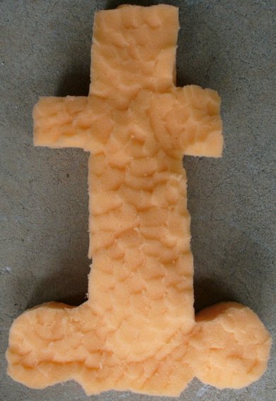

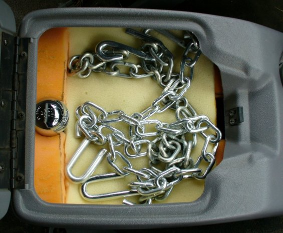

Finishing up the center console project had 'lazy Sunday' written all over it...
Center console foam insert for tow hitch, hitch pin & spare clips, coupler lock, and flashlight just for the hell of it.
I decided to center the hitch, which made it a tight squeeze for fitting in the safety chains alongside. They'll have to go somewhere else. Or...
I planned that as a tray to still set small things, but it might suffice as a spot for the chains.
Well, that's unfortunate... All that foam cutting is hard on the wrist!

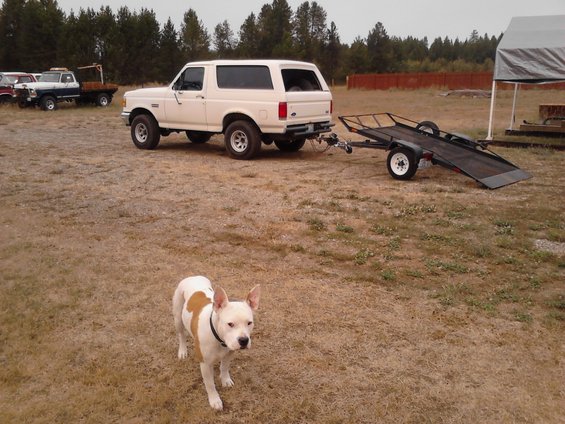

Sorry, I didn't mean to ignore you. I just saw this post when looking back through the thread for something.
I have wondered about that, as the tire carrier feels like it would torque things quite a bit extended out, even if somehow bungeed to the lowered tailgate. If I need to haul anything that long and wide (i.e. that can't be pushing up between the seats for extra length), my two thoughts are:
1) Use a trailer.
2) Take the spare off the carrier and bungee it with minimal weight on the end.

every dedicated Bronco owner needs a trailer. I picked up a tilt-load golf cart trailer for $600 off craigslist and I love it.
