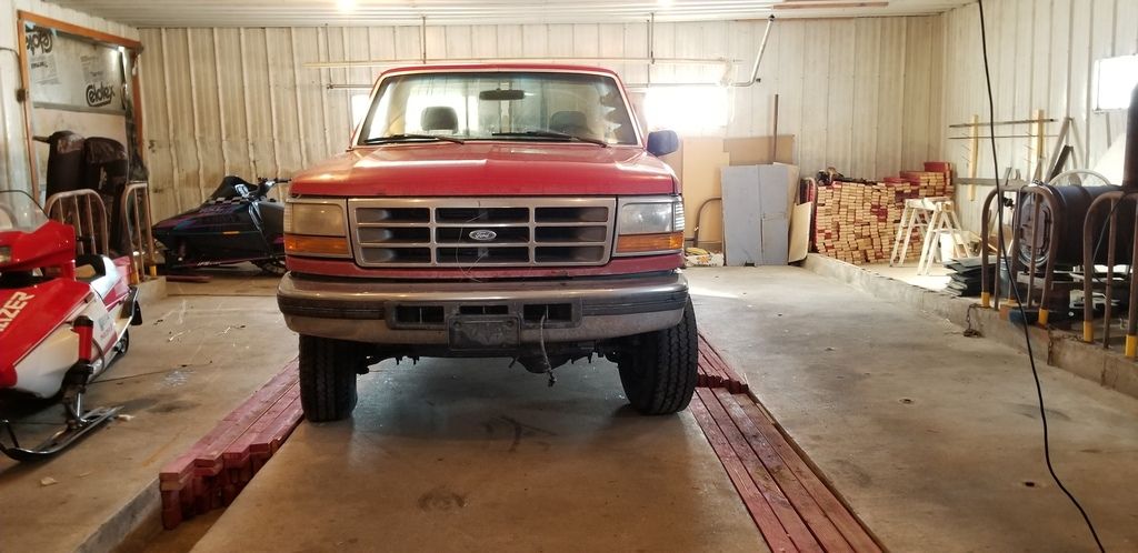

I picked up an exciting truck this weekend to start me new project. I got a hold of a 1997 F350 regular cab with 4x4 and a 7.3 powerstroke for $3200. I was originally very weary of looking at this truck because its at 350k and the body has a good bit of rust (but doesn't matter because I don't need it). The owner before the last was a ford diesel mechanic and "allegedly" swapped out the transmission, turbo, and injectors. There was no papers for these parts but the condition and performance of the rig seemed to look like those parts have been changed within the last few years. Transmission shifted exceptionally good, climbed up and down the gears very quickly with no slipping, hesitation, or reving up between gears. I inspected the turbo and it wasn't dusted or oily and no slop in. On a cold start if fired right up with a very light blue smoke similar to what a early 6.7 looks like when those cold start. Smoked cleared with in minute or so (air temp was ~20*F) if in the summer if it still has a faint blue hint I'll rebuild the turbo and replace the seals. Under hard throttle there was no smoke what so ever, which I was pleasantly surprised to not see. When it was warm I checked for blow by and there was none.
In this deal I got a rust free cab, 2 100% rust free and dent free door that were primed, 2 doors rust free with a dent in one with factory paint, 90% clean box and a bunch of other interior plastics, glass, steel trim, and a whole ac unit/ box getup thats in the corner of the engine bay. The person i got it from also put in 2 new motorcraft batteries, glow plug relay, and shift linkage on the column. It shift better that shifter in my bronco. Planning selling all these extra parts. I already have a friend that's interest in the doors, cab and box so thats good.
I'm planning on doing this build over stages and keep upgrading as time goes on. My goal for this build is to have everything transferred and over from the donor and functional by the beginning of May.
This week I'll be ordering all of the big things for the project. So far my plans are to order:

Some preliminary photos of the truck
Started by removing the disconnecting all harnesses and hose and removed the front clip and fenders. The front clip was rusted to all hell but luckily the part off it I need is still solid. The fenders were pretty much destroyed and I had to some bolts off and drained all the fluids.
Front clip fully femoved
Got the transfer case off with some persuasion and breaker bars. For my build I'm planning on using the the BKOs automatic case and then the D60s manual hubs.
Cut the front cab bolts so I could remove the transmission and engine with the pedestal still on the motor.
Engine fully removed
