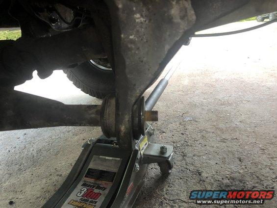

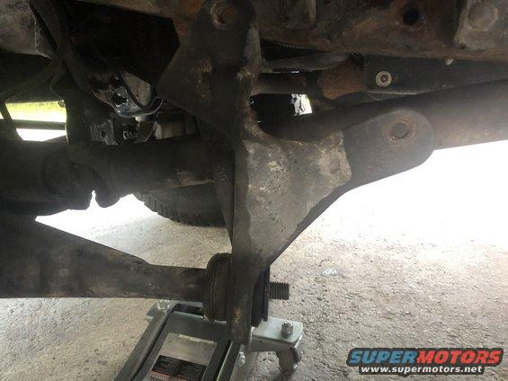

Got a late start, but I did get the LH radius arm poly bushing installed. The bushings looks to have been replaced, but they were cracked and seem to have shifted a bit.
Broke the radius arm bushing nut loose, then dropped the radius arm drop bracket. Replaced the bushing - but I did have to loosely bolt in the bracket, then use the big washer and nut to pull the radius arm bracket further into the bracket. Then I tightened the bracket down, removed the radius arm bushing nut and washer, then slid the outer poly bushing on and bolted it down.
cobrajoe likes this.

You'll notice the nut for the radius arm bushing doesn't go on as far as with the stock (or the OEM type replacement my truck had) setup. That's cranking it down with the impact. I'll verify torque settings once I do the other side.
TIP: You can do this without jacking the truck up (if you have bolted on radius arm brackets or you plan on cutting the rivets out and replacing with bolts) but MAKE SURE to CHOCK the tire of the side you're working on. If you don't - when you loosen / take off the radius arm nut, the radius arm will move towards the front of the truck, which will make lining it up a pain. Once I figured that out it was actually easy.
I'm sure I'm jinxing myself, but I figure I can do the RH side in 30 minutes or so. I degreased the heck out of the underside of the truck and sprayed it off AFTER changing the LH side - since the most time consuming part was finding my safety glasses since mud and dirt kept falling in my face when I was removing the radius arm bracket.

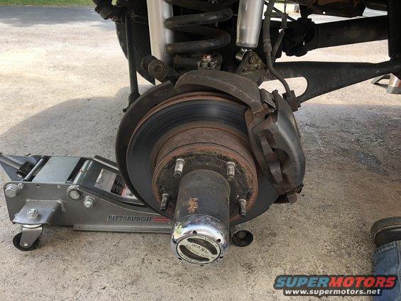

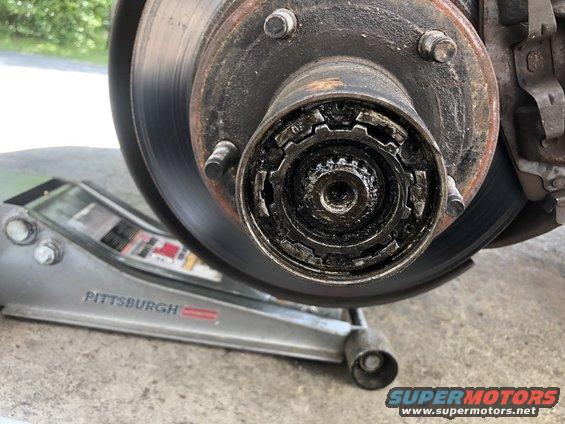

Well got the other radius arm bushing installed - then started to tear into the brakes.
So I started on the LH side - the same side where the hub does not lock in. It turns fine, everything seems fine from the outside, but doesn't lock in.
Were factory manual hubs Warn hubs? Did all electronic shift 4WD models in '95 have auto hubs originally?
Got the hub cap off - missing two screws of course - and this spring was resting inside the hub. I'm guessing it's supposed to be that way.
The PO took all this apart to install new ball joints (verified they are new and Moog) and didn't bother to clean the old grease out and repack the bearings...
Jeez, talking about dirty
Outer wheel bearing came REALLY easy - as in it basically fell out before I ever started pulling the rotor off the spindle. But the spindle nuts weren't overly loose I don't think. Good news that number matches up to the TIMKEN SET45 I ordered.

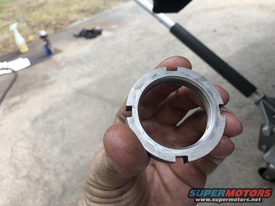

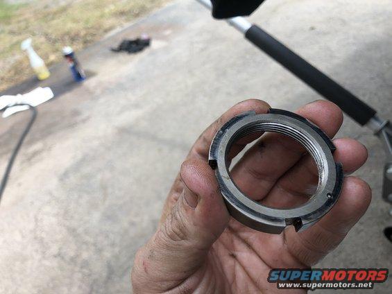

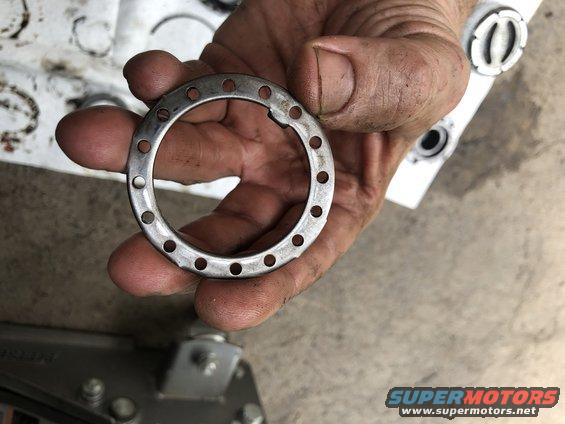

Inner spindle nut - notice no 'nub' or lock tab - shouldn't it have a piece that locks into the hub washer?

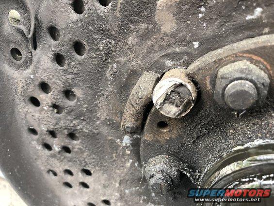

So apparently someone got the 12 point 6mm bolt off for the ABS sensor but either forgot it or destroyed it removing it - so no bolt holding the sensor in and the end of the sensor looks chewed to hell
Hammer and brass drift made short work of the wheel studs and the drove the ABS tone ring out as well
Need to order ABS sensor might go ahead and do hubs too.

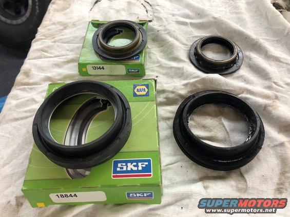

My '95 is a 11/94 production date. So it doesn't have the newer style 2 piece seals.
Went to the local NAPA figuring (from seeing multiple posts on various threads here) they would have the spindle seals. The guy working there - who has likely worked there for YEARS - simply didn't know how to run the computer and couldn't navigate the parts catalog for anything.
Was able to navigate their website and find what look to be the spindle seals:
Front Outer Spindle Seal PT#13144
Front Inner Spindle Seal PT#18844
So I'll head there in a bit and pick up the seals and the spindle bearing. I need to pick up some grease anyway.

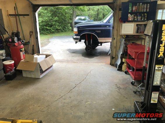

The hubs were just NASTY. I've been eyeing a portable parts washer at Tractor Supply for a while now, so I went and picked it up last night along with 5 gallons of their parts cleaner. In a bit I'll head out and clean the shop up - since it's raining today and the '95 won't fit in my shop (too tall).
Hindsight being 20/20 - I think I'm going to hit the junkyard next week and see if I can pick up 4 stock f150 wheels and tires that at least hold air. Hoping switching to those will allow me to get the '95 in the shop - I'll have to do some measuring.
Plan today is to get the shop straightened up, get the parts washer put together and filled up and start soaking the sub and other parts and hopefully get to removing bearings / races and replacing.

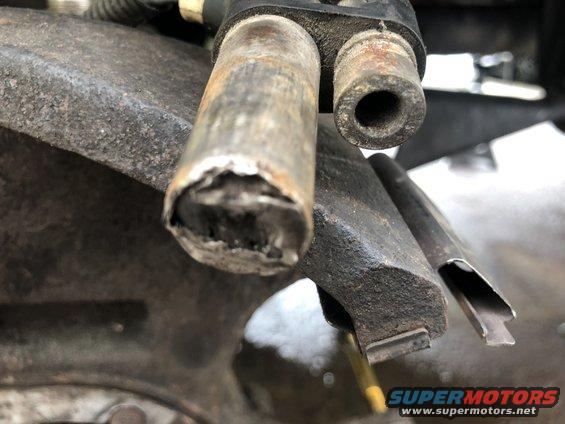

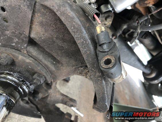

So I'm guessing that's what left of my ABS sensor shield?
So yeah, I'm thinking that's not how the sensor is supposed to look like.
So I'm searching threads - apparently the sensor shields are unobtanium. So should I buy a new sensor and install it and leave the remains of that shield there or remove it - and just run the sensor?
I really don't want to disassemble the '93 Bronco to pull the shields - that's betting they are still there and I can get them off in one piece.
I've got some thinking to do. Considering pulling the relay that runs the 4WABS system and simply removing the sensor. I'll search threads here and see what I find.
Have I mentioned how much I love previous owners? Apparently they rounded the bolt off on the shield and just broke the shield off so they can remove the spindle. Gotta love it.
Did get the shop cleaned up enough to work. Trying to rain like hell here too. Also got the parts washer together. Ended up buying one at Tractor Supply - it won out because it's portable and still holds 20 gallons. Need to go get another 5 gallon bucket of parts cleaner. Unfortunately my local Tractor Supply doesn't carry it - so I gotta go a ways down the road.

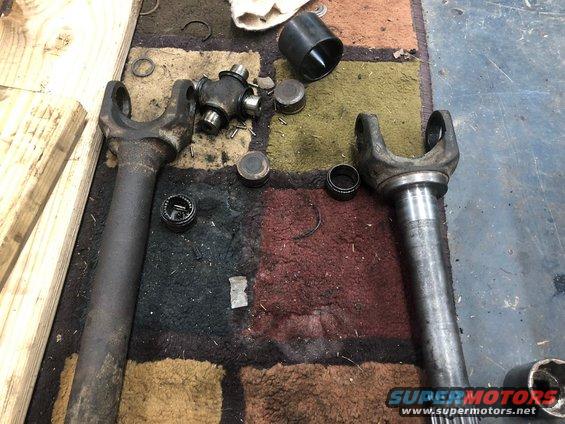

Got the spindle, hub and front axle stub soaking (it's getting a new Spicer u-joint).

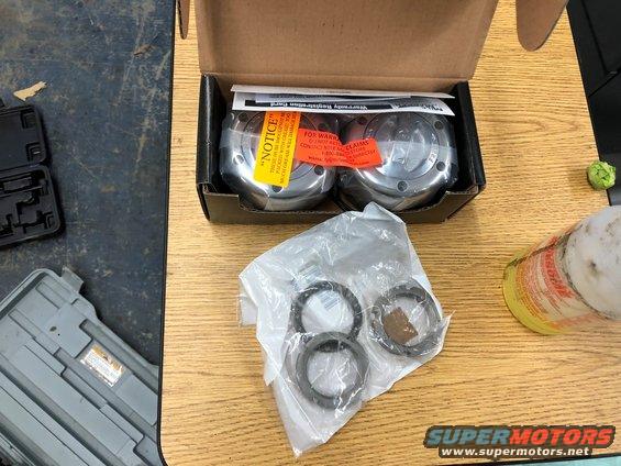

On another front, I was able to find the correct inner and outer spindle seals and bearings at a local NAPA.
Everything listed in most catalogs for my '95 is wrong. Production date of 11/94.
Now I have to figure out the official name of the spindle nut with the locking nub / tab. The tab was gone on the one I pulled from the LH side on the '95.
Step by step.
cobrajoe and SRWillis like this.
__________________
1995 EB (Number Three),1993 EB and 1996 XL - The donor twins. My build thread:
https://www.fullsizebronco.com/forum...es-threes.html
ctandc is offline
post #54 of 120 (permalink) Old 05-05-2019, 04:48 PM Thread Starter
Join Date: Jul 2018
Posts: 343
So if anyone else needs this -

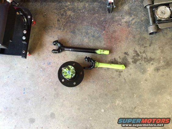

Dana PT#28068x is a spindle nut set (1 side)

I think I'm just going to unplug sensor and run it.
Got the races out of the hub and let it soak some more.
Fighting the spindle bearing right now. The slide hammer set up I have just won't bite on the smaller spindle bearing.

So I mentioned before I tore the LH side apart - that the LH hub (Warn Manual hubs) would NOT lock in. The dial turns and it's not hard to turn, but turned all the way to lock - it never engages (the front axle does not start moving). RH side - identical hub - works just fine.
The Warn hub itself is a sealed piece. And while the LH hub was FILTHY, I cleaned it in the parts washer, then clean it with brake cleaner - it appeared to be moving back and forth fine. I figure I'll need to order hubs, but didn't want to order them without knowing for sure something was wrong with them.
After some more research - turns out that the spring that fell out when I pulled the hub cover is not supposed to be loose.
That spring on the right is supposed to be installed on the threads of the dial inside the hub on the right. I'll take a look at it tonight and see what's going on with that.

Well since the LH hub was missing a couple of the hub cover screws, I figured I'd order a service kit. Well service kit is close to $30 and doesn't include the spring in the picture. Ordered a set of the Mile Marker Premium's for $70.

Last night had a few minutes to work - so I got the old u-joint out. I'm betting factory u-joint. Honestly wasn't in bad shape for 24 years and 250K miles. I feel better about going with spicer replacements.
Gonna mask the hub and axle hubs off and shoot a bit of paint on 'em to clean 'em up.
Getting ready to head out to the shop and do that - then go ahead and break down the RH side.
Clean all that up, then start getting everything ready to install. Goal is start putting it all back together Saturday morning, then go ahead and install the Skyjacker drop pitman arm and AC Delco steering box.
After that, it's time to start tearing the engine down and get that handled.

Had time to get the RH side stripped down.
Rinse, repeat - dirty, nasty grease. ABS sensor shield all the way gone and at least the sensor had a bolt holding it in. Got the hub loose and it and the spindle are soaking.
Did get the LH axle cleaned up:
Mile marker hubs and spindle nuts / washer came in (had to order another one)
Tomorrow try to get the u-joint removed from the RH axle. Get it cleaned up and painted.
By Thursday get the new races and bearings installed. Plan is to get it all back together Saturday morning.
