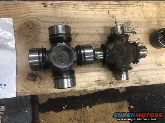

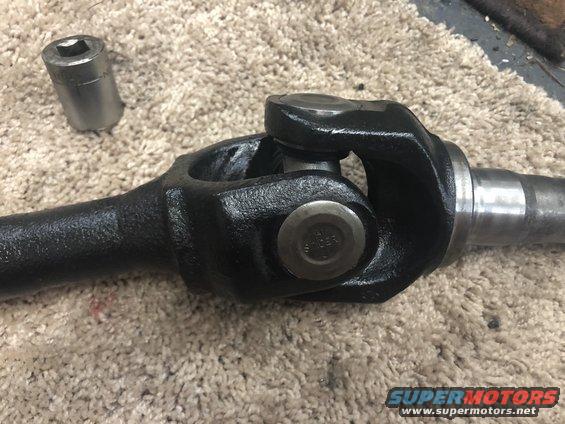

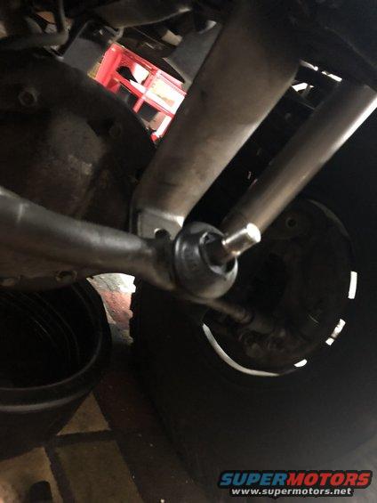

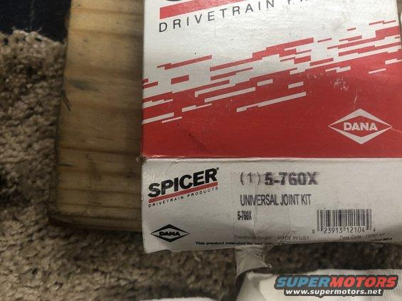

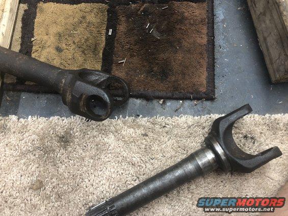

Got the old u joint out of the RH axle. Short work with a hammer and a couple of sockets
New vs old. Spicer lasted for 24 years and 250k miles so good enough for me
Same pair of sockets and a few minutes later
Got the LH axle ready to install. RH axle soaking in parts cleaner.

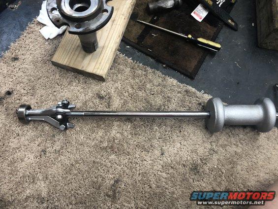

Got my new slide hammer setup. Fifteen minutes later - spindle bearings out

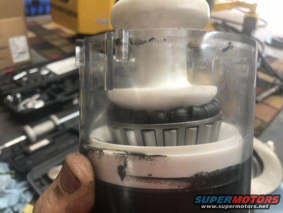

Grabbed this bearing packer - found it when I moved. Apparently I bought it and never actually used it. Man - this makes it easy.
Inner bearing installed. Seal installed.

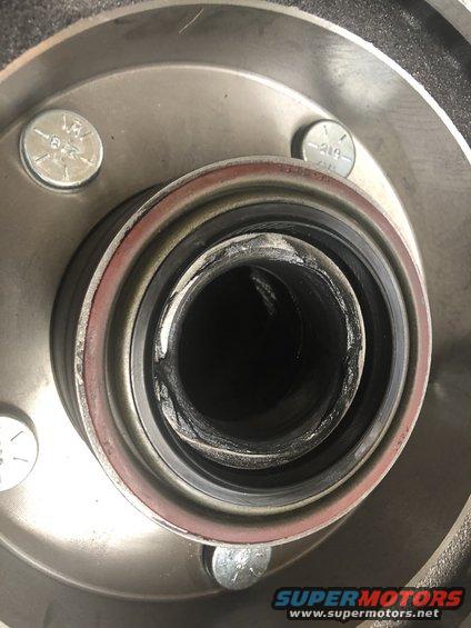

And seating the outer race flush - simply ain't happening.
I posted a thread in the tech forum:
https://www.fullsizebronco.com/forum...ml#post7203622
I went back through pictures and there was a race that wasn't seated all the way. I'm assuming the hub is tweaked. Looking to order one now.
New Raybestos hub on rock auto? $33 + shipping. NAPA? $138
You gotta be kidding me.
So I'll be ordering one shortly.

So the hub should be here Tuesday. Also had to fork out $7 via Amazon to order a new race for the Timken 45 bearing set (outer wheel bearing). So while I'm waiting on that - I was talking to a friend of mine and we started wondering just what effect the race being crooked in the hub would have on the truck.
Like I mentioned before - the race wasn't seated all the way when I took this thing apart. I had pictures when I was driving the races out and I distinctly remember thinking it was odd - that when I was driving this one race out, the 'lip' (looking down from the back side of the hub towards the backside of the outer wheel bearing race) wasn't the same size all the way around. Well - I know why now. The question is - the race wasn't straight. Maybe 2/3 of the race was FLUSH but roughly a 1/3 of the race was not flush. So in essence the outer wheel bearing was cocked outward towards the tire because of this.
It also explains why the outer wheel bearing on the LH side basically popped out as soon as I got the spindle nuts /washer off.
I wonder what effect this had on how the truck drove? Guess we'll see when I get all back together this week.

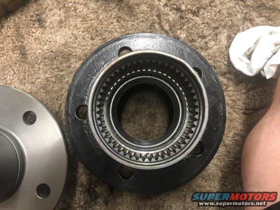

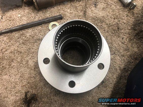

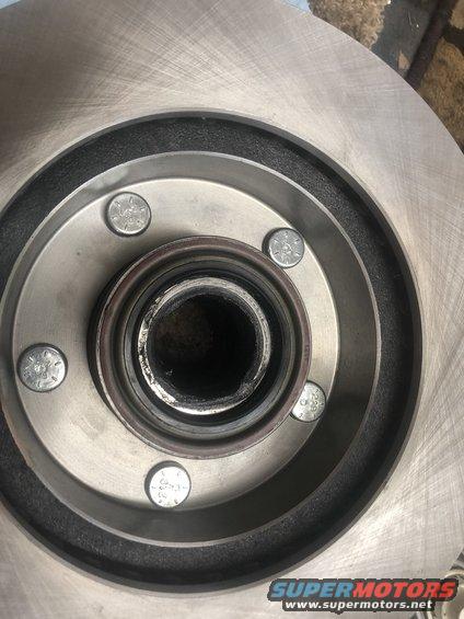

Got the new hub in. Raybestos PT#4440R. $33+shipping via Rock Auto or $139 from NAPA. Your choice
It comes with new bearing races installed and new wheel studs. Didn't know that. If I had known that, for the money - I'd have likely replaced both hubs and just bought the Timken bearings themselves with no races. You could do new rotors, new hubs, new bearings and new wheel studs for under $200 for both sides.
So remember I mentioned the race wouldn't seat flush (only on PART of the race)? Guess I didn't notice the BEND in this hub when I was cleaning / working. That explains a lot.

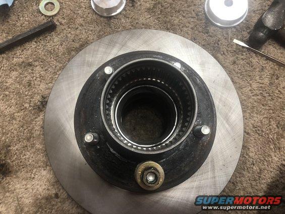

Installing the rotor onto the hub. It's a press fit, held in place by the wheel studs. Get an open end lug nut, some washers and an impact. You could use a breaker bar - but even a inexpensive battery powered or corded impact should do it and impacts make life SO MUCH easier when working on vehicles - especially ones with bolts / nuts that haven't moved in 20 years or more. The washers cover the gap of threads where the shoulder of the wheel stud is - so you can use the wheel stud threads to pull the shoulder all the way into the hub. Whole operation (5 wheel studs) takes maybe 15-20 minutes.
Here's the shoulder of the wheel stud I mentioned.
Me personally, I like putting fresh grease inside the depressed cavity (inside the hub) between the inner and outer wheel bearings. Not enough that will interfere or get dislodged when sliding the hub assembly onto the spindle - but a good bit spread around in there.
Packed the inner wheel bearing with grease, inner wheel seal installed:

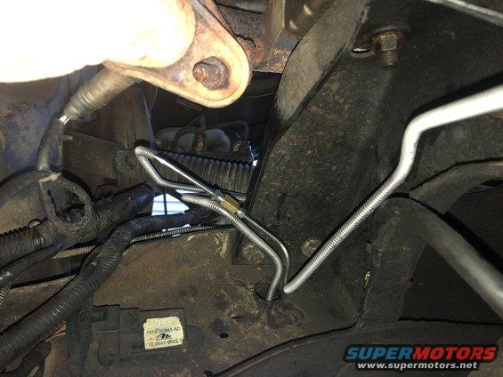

I don't like getting beat. So after thinking about it last night, I figured that the difference between the Inline Tube pre bent brake line set for 93-94 (What I have - I bought it when I was planning on reviving the '93 EB) and the 95-96 kit couldn't be all that much - in regards to the lines I need - which are the lines that go from the ABS pump to each caliper.
WARNING: If you plan on buying pre bent lines - go for it. But I will tell you not to rip your old lines out without trying to keep them intact. It's almost impossible not to tweak or even cut the old lines to get them out, and to make it even more fun - the new brake lines aren't labeled.
If you aren't good at puzzles - find somebody who is.

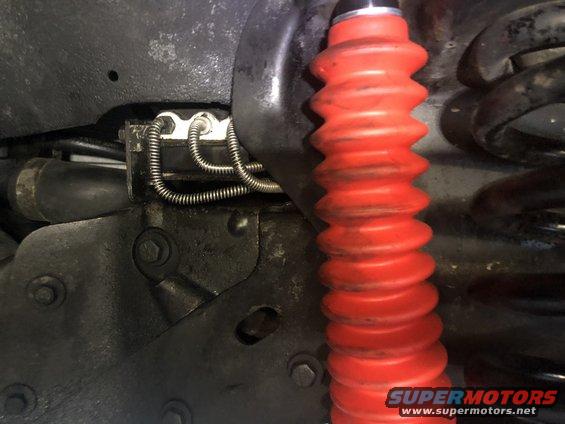

The new line set comes with two unions. Unions that join normal double flared lines. From going through them all - one of the unions is for the front most line that goes into the ABS pump. This line (far left in my picture) goes from the ABS pump on top of the LH frame rail, bends down inside the frame rail and connects (union) to the brake line headed towards the rear.
So here's the lines I'm talking about. From the LH fender well.
The line on the right leads to the RH caliper. The middle line goes to the LH caliper.
The line on the left is the one I mentioned above - goes to the rear.
NOTE: The line on the left at the ABS pump has a small connector, the middle line is larger and the right line is another small connection. You can tell which lines go to the ABS pump because they are bubble flares.
So the second union supplied by Inline Tube connects the line (right in picture) that runs to the RH caliper. The line connects with the second part of the run right against the frame rail.
I went ahead and replaced the middle line (going to LH caliper) because I was in there. I left the line heading towards the rear along. Didn't want to fight the connection where it goes into a union heading towards the rear. It looks fine.

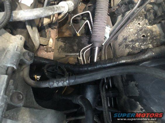

I took all the lines with bubble flares and mocked up each until I figured out what went where.
The HARDEST part of this job - so far - was getting the lines in place where they connect to the ABS pump. Had to remove the 3 13mm bolts holding the ABS pump on the bracket, and physically move it enough to run the lines. They run right up close to the LH shock tower.
I have big hands. No room to get the fittings started. Finally able to get to it from above, holding the ABS pump at and angle and threading the fitting with the other.
Now all I have to do is tweak the line that goes to the LH Caliper and tweak and connect the line(s) that head to the RH caliper.

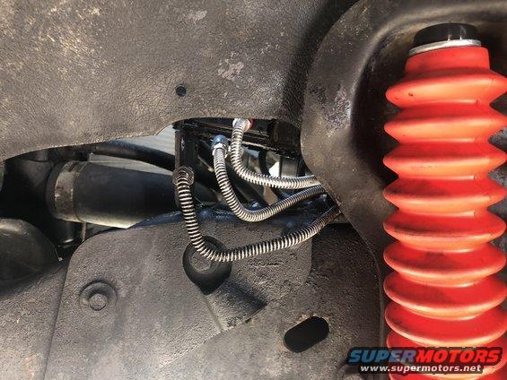

Surprisingly no. Got the junction installed for the RH caliper line that runs across the crossmember. Got the new line on the RH caliper installed. Got the hard line hooked up to the LH caliper line.
So all I need to do is install the new LH Caliper, tighten down the ABS pump and plug it up and bleed the system.
New lines connected to the ABS pump. Not fun.
I will tweak these lines a bit to clean them up.
This is where the RH caliper hard line connects and runs across the cross member to the RH caliper.

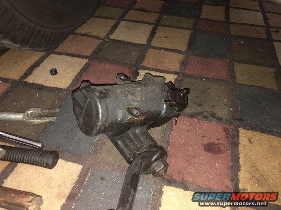

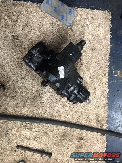

Disconnected the upper steering column, disconnected both power steering lines, got the drag link off the pitman arm and got the old steering box removed.

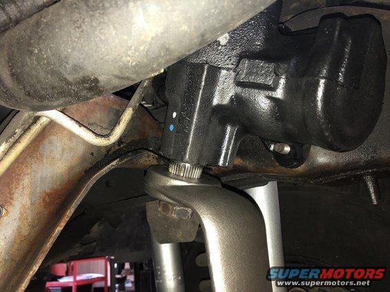

New AC Delco steering box ready to go in:

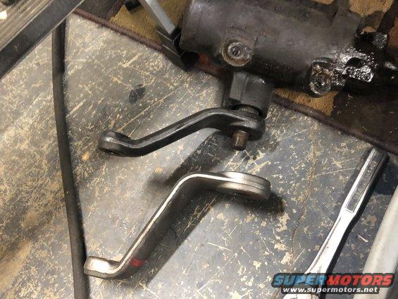

The new Skyjacker extreme drop pitman arm compared to the already installed 'normal' drop pitman arm:
New steering gear went it with zero issues.

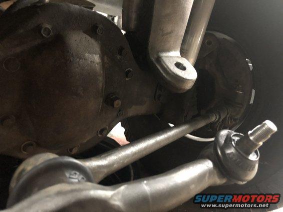

But unless I'm missing something, there's no way the Skyjacker pitman arm is going to work.
It won't match up with the drag link. I was going to try and break loose the LH tie rod from the drag link and go from there, but it looks like the LH tie rod would interfere / hit the drag link IF I could get it to match up. Keep in mind both drag link and all tie rods are newly replaced right before I bought it.
I'm going to remove the old drop pitman arm and install it on the new box and see how it drives from there.
Anyone else had experience with installing the FA600 Skyjacker extreme drop pitman arm? I found a couple of threads mentioning have it installed - but no issues I could fine with installing it.

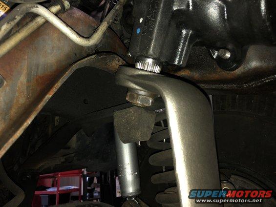

So had a bit to work on the 95 today.
Picked up a pitman arm puller and got the old drop pitman arm off the old steering box.
Then ran into the same problem when loosely installing it on the steering box - the drag link (still connected to LH inner tie rod) still wouldn't bolt up. So I removed the LH inner tie rod from the drag link.
Decided to go ahead and try to install the Skyjacker extreme drop pitman arm. It went on - key way matched up, drag link bolted up with no adjustment - but I did have to screw the LH inner tie rod IN about 5-6 turns and it bolted right up to the drag link.
Keep in mind - started all this work with the truck on the ground - tires pointed straight ahead, steering wheel centered / locked and secured with the seat belt. Steering shaft matched right up with the flat on the new steering box. Steering box was centered.
Need to torque everything - may try to take a quick road test tomorrow but I have other stuff I have to do - so it might be Sunday.
I'll get it aligned this week.
Also - this is as far as I could get the new pitarm on. Keep in mind - new steering box as well. I'll try to use the impact to see if I can get it to go on further. Had my 3/4" torque wrench set to 200 and I couldn't get it to click to torque.
cobrajoe likes this.
