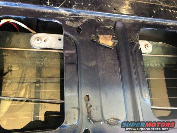

Well I crawled in the back of the '96 XL. Scored a few tools, and a shotgun shell carrier.
The tailgate access panel in the '96 looks like it's never been disturbed. That's good.
Realizing the '96 XL doesn't have rear defrost - the '95 does.
Did set up a quick rig that lets me get the tailgate window up and down without crawling in the truck. Like a sauna in there. New weight loss program.
So then I crawled in the back of the '93 EB...with rear defrost. Rear window hasn't been down in 15 years. The motor works. After a ton of pb blaster etc - it went from barely moving to moving a few inches. It seems like one side of the regulator is frozen. I'll search threads and see what I can find.

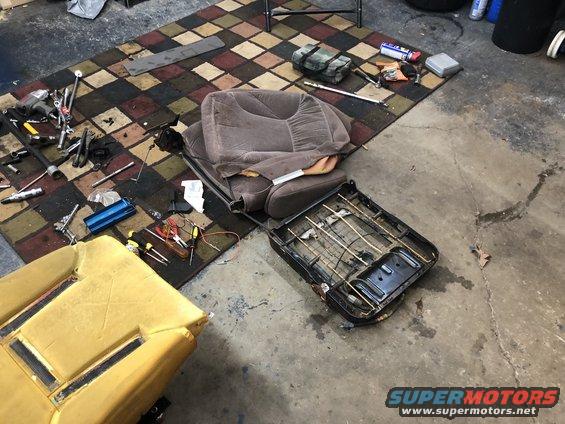

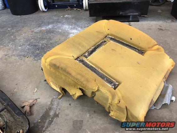

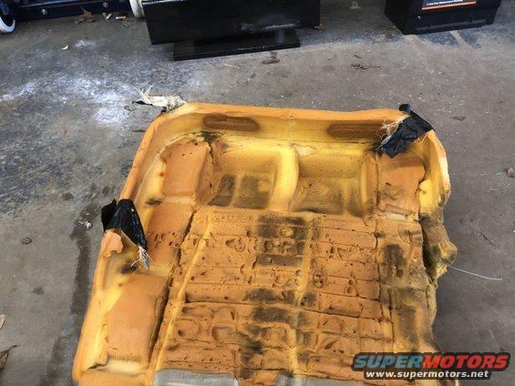

Here's the passenger seat cushion from the '93:
And cut outs on both sides of the cushion:
It will be a direct replacement for the worn driver's cushion in the '95.

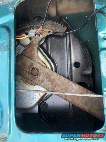

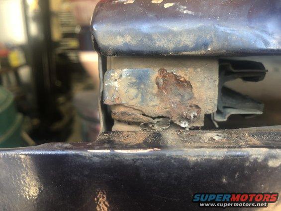

For anyone who can't get the tailgate window down, the first option is to remove the access panel, unplug the window motor connection, get a battery and two pieces of wire and simply try to get it down by directly powering the motor. If that STILL doesn't work - like in my case where the tailgate window on the '93 LITERALLY has not been down or open since 2003 (at least), then odds are - if the motor tries to work - the rollers / guides the connect the regulator to the window track are likely frozen.
Like this - All I did was Try to move the guide (still attached to the regulator) after I got the window out.
In that case - grab a wrench (12mm or 7/16" can't remember at the moment) and reach up inside the access panel and take off the two nuts on either side of the window track that hold the glass to the regulator. Bumping the power to the motor at this point will jar it enough to allow you to move the regulator arms off the studs on the guides and get the window free of the mechanism and allow you to lower it manually.
First time in over 15 years this tailgate has been lowered:

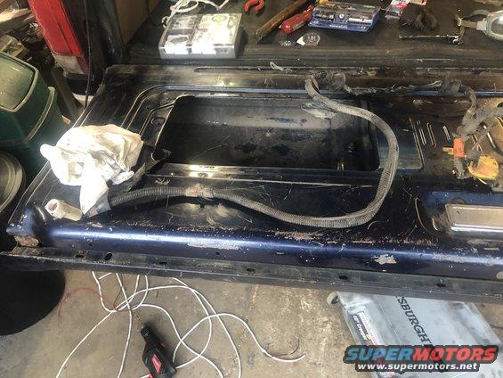

So all that work to get to the tailgate harness in the '93 - since it has rear defrost and so does the '95.....and someone has already "modified" the harness. In reality - it was unplugged underneath the truck and it appears someone just ran a wire to the battery at some point to power the tailgate. I guess. It was closed off with a wire nut. God I love previous owners.
The safety switch on the LH side of the tailgate is GONE. They jumpered the wiring harness to bypass this (they were good enough to crimp this connection). I got the entire harness out of the tailgate - only to find out they apparently just REMOVED the rear defrost wire from the harness. It and the rear defrost harness is GONE. On the plus side the tailgate switch seems like it's in good shape.
On the plus side - the tailgate isn't rotted. It's got some scale surface on one inside corner but ZERO rot. So at least it's consistent with the rest of the truck. I honestly believe the top has NEVER been off the '93. All the trim and trim screw hole plugs are intact and not broken.
At this point I need to search the tailgate tech stuff and figure out how to remove the tailgate key switch. It looks like I have to remove the exterior trim panel to remove the key cylinder itself - I'll try that and see what happens I'm going to rob the key cylinder from the '96 because I have a key for it and it worked before. At this point it looks like I'm going to build an entire new harness using the plugs and seals from the '93 to install in the '95. I just have to find where the rear defrost ground actually bolts up - inside the tailgate itself or inside the tail light housing. That wire was cut on the '95 as well.
I want to get the tailgate working from both switches, lubed up and working well, so I can button up the dash on the '95 and install the new instrument cluster I scored + the mint trim bezel I got from the same parts truck.

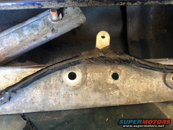

Okay so after some digging I found some pictures and other things that I'll leave here to help me document getting this repaired.
Here's a picture (courtesy of Steve83 ) of the later model tailgate wiring harness:
Once I get the '95 back in the shop, I'll verify what I got - but at this point I would feel better about taking the pieces of two harnesses I have and wiring up a new one.
The rear defrost consists of two connections. One wire is the ground, one wire is the hot. They both apparently connect to the window.
The ground connects to a tab glued to the silver connection on the glass connected to the defroster grid. Looking at the tailgate with it down - it's on the RH (passenger side) a short distance to the left is the hot for the defrost - which connects to the same type of tab.
So two of these are used:
https://www.amazon.com/Rear-Window-D...gateway&sr=8-1
Again, one for ground (grounds to inside LH tail light housing) and one for hot.
You can also buy new connectors from Frost Fighter as well and they even make a special epoxy to reconnect the tabs to the silver insets on the glass that connects to the defroster grid. But that epoxy is like $40. The connectors (which are just female spade connectors with a clip on plastic housing) are like $6 + shipping.
Me personally, I think I'm going to salvage two tabs from the '93 and '95 rear glass as needed and solder it back on the window. Won't cost me a dime. Then I'll crimp and solder on new spade connectors (again FREE) and then use heat shrink around it.
I'll take pictures when I get the '95 inside the shop and start building the harness.

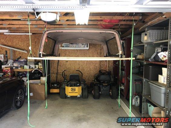

Going to get the '95 inside the shop and start work on the wiring / interior. Get the tailgate wiring / switches squared away, install the power mirrors from the '93, strip the interior and install sound deadener under the vinyl mat, replace / repair / dye all the interior panels, dash panel and install stereo, speakers, console etc.
Likely I'll pull the top while I'm doing all this to make it easier.
Then after that, it's tear the top half off the engine, water pump, hoses, thermostat, gauges, headers etc.

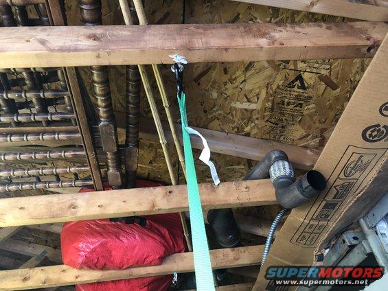

Okay so I've been tied up working on the house. I was finally able to get a simple hardtop storage rack built so I can store the top, get the '95 into the shop (without the top) so I can start rewiring the tailgate, stripping / fixing the interior panels, getting all the wiring straight etc. Having the top off makes that much easier.
(4) ratchet straps + (2) 8ft 2x4's, + (4) u-bolts + (4) lag eye bolts. Total investment around $30. Takes maybe 30 minutes to install, even less to get the top on it once the top is unbolted.
I park my '17 Mustang under it in the garage pictured with zero issues.
Pictures should be self-explanatory

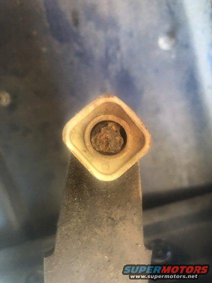

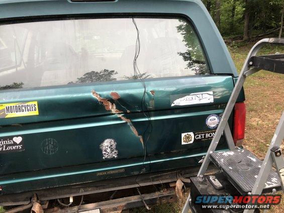

Okay so I finally started on the tailgate. Got the key cylinder removed from the '96 and started tearing down the '95 Tailgate.
Noticed one thing - the '96 XL has an interior brace for the tire carrier, even though it doesn't have one.
So I started tearing down the '95 EB tailgate. If you run the tailgate window almost always the way down, you'll line up all the bolts so you can easily remove the regulator. NOTE: As has been posted here numerous times - the regulator is harmless if the window OR the window motor is still installed. Take both off it'll spring shut (it's pre-loaded) like a rusty, dull bear trap.
Unbolt the window from the regulator / slider arms by removing to two nuts on each side of the window.(11mm). They are easily accessible on the LH side as pictured.
On the RH side they are reachable with a 7/16 ratchet wrench. (I couldn't find my 11mm wrench)
After you get these removed - you can push down the channels attached to the regulator arms and the window is essentially detached.
To fully remove the window you need to remove the two weatherstrip end caps. Remove the screw on each, tilt it up and it comes right out. I'll be replacing these anyway.
Next you need to remove the inner and outer weatherstrips that run the length of the tailgate. I'll be replaced these too. Take the screws out on each end then use a small screwdriver to pull the clips that hold the weatherstrip out.
Now the only thing holding the rear window in - are the clips that are taped into the wiring harness.
Personally I like popping the top tabs off - as seen in the picture. That way when I reinstall the harness I can simply use a zip tie to hold the clips. I've dealt with those on other vehicles and it works well - it's easy and it's free.
With that, I pulled the window out - and found a spot for it in the back seat. Next up pulling the regulator. IF you lined it all up to begin with you can unbolt it. You'll need to remove the two bolts on the RH side of the tailgate that hold the black inner tailgate carrier brace and remove the brace.
Then just remove the other 3 11mm regulator bolts and you can get the entire thing out through the opening on the LH side.
You can see the motor on the '95 was replaced.
I also bought new window rollers. These are trashed. To install the replacements, I'll have to drill these rivets out and bolt in the new ones.
And so I've got the famous separation of the outer tailgate skin. I'll have to make a few calls and get someone to weld in a couple of small metal braces.

Next up I removed the entire harness. For those who don't know - the switch activated by the lock cylinder in the tailgate is permanently wired into the harness. So I wanted to test it to make sure everything actually worked. It didn't. So I cut off the harness that plugs into the safety switch - this switch is located on the LH side of the tailgate (inside). It senses whether or not the rear window is all the way down or not. If the window is NOT down all the way - it interrupts power to the window motor. If it IS down all the way - it passes power and the window motor can run. Apparently the switch failed (fairly common I'm guessing) and a previous owner simply wired directly to the motor wiring to make the window go up and down.
To remove the harness - unplug it underneath the rear of the Bronco. Then remove the LH taillight. Pull the harness up through the hold in the body on the LH taillight housing. If you have rear defogger - don't forget to unbolt the black ground wire that is connected inside the housing as well.
Then push in the seal inside the housing and keep pulling harness to the tailgate. Same with the seal where the harness enters the tailgate. There is a wire clip hidden by the LH side window rail (where the rear glass travels) you can remove that easily - two bolts on the outside of the tailgate. Disconnect other wire clips / connections (some shown above) and you remove the entire harness.
So after cutting off the harness that plugs into the safety switch on the LH side of the tailgate, and connecting those wires, I connected the window motor wires (red / yellow) and connected the harness underneath after cleaning the connectors.
Now the switches operating by the key / lock cylinder work perfectly. Turn the key on - the dash switch works as well.

Now I need to dig in to the best way to repair the split on each side of the tailgate outer skin. The way it's placed - and the metal that's still there - I almost think a small metal brace drilled and bolted in would work better and be much easier than welding.
