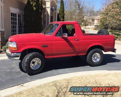

I guess I never really did a build tread on my 1994 Bronco. It's a little late to try and remember what all I've done to it, but here's some info and pictures anyway.
Bought it about 5 years a go. It had a bad motor and also needed a transmission. It' only had two Little rust spots in the tailgate. Rust of the truck was dent and rust free.
Here's a day I had it towed to my house
Installed a used 1997 F250 5.8L with 120k on it. While I was at it I replaced the oil pump, water pump, spark plugs, wire, distributor cap and rotor, and all new belts and hoses. From there I drove it to the body shop to get it painted. Here's a picture when I picked it up.

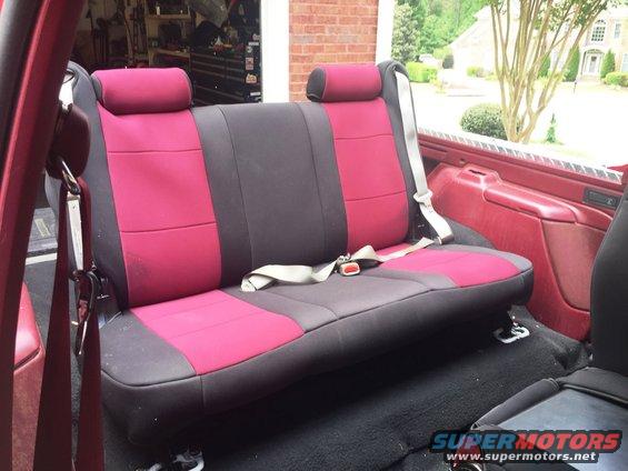

Added a rear seat from a the 3rd row from a 2001 Suburban because it had headrest and shoulder belt. Had to rise the floor up about 3/4" so the Suburban seat brackets would work properly. Did this using 3/4" plywood and then sealing it up good with stick on rolled roofing so the wood wouldn't get wet.
Then I installed all new black carpet.

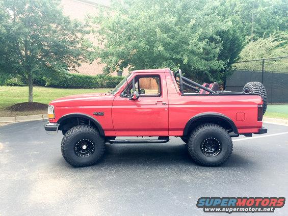

Installed a roll bar I bought on ebay. Had to remove the rear side panels so It would fit in the truck better. Made some new panels out of 1/2" ply and covered them in black carpet.

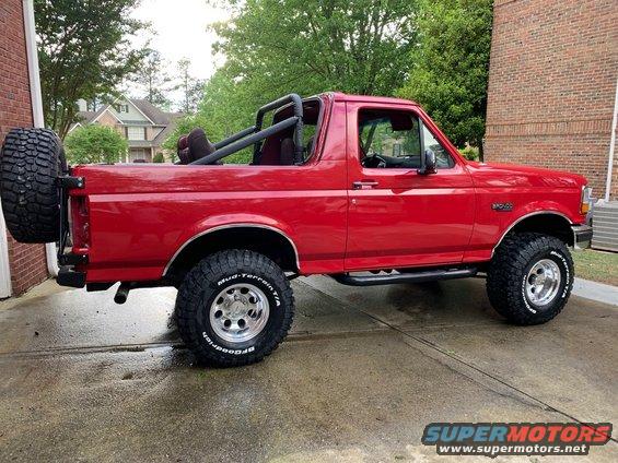

As time went on I ended up wanting to lift the truck. Went with a 4" Rough Country lift and added JBG 1700 lb rear springs instead of the 4" rear block that came with the lift.

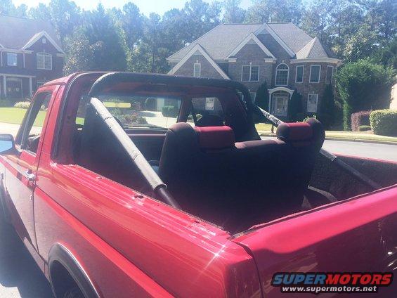

Put some tie downs on the roof to use with an over head hoist in my garage when removing my top. Also bought a Rampage black canvas top for it.
