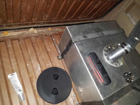

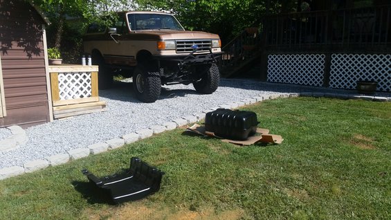

I got tired of trying to slow fill the 20 gal aux tank I had made for the bed
So I decided to redneck up a dual tank setup with a new 32 gal stock tank as the main
I put the main tank pump on a toggle so it can be shut off when using the aux tank

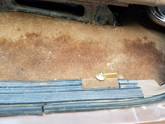

Used a 3-way marine valve that accomodates the return lines
Mounted to a plate that tucks up above the sliders and is acessed beside the driver's
seat like the eb's
It worked out pretty well giving me a 50+ gal capacity. Jaz cap above stock
