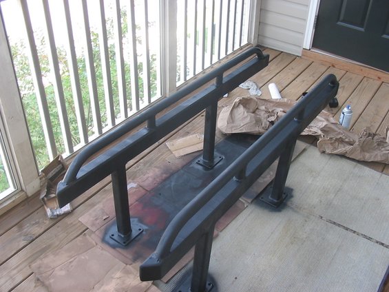

This thread wont have much tech in it per se, but will have various designs of sliders. Started the thread cause i am building mine now, been researching, and there wasnt a single consolidated thread. Ill post mine up when I am done
Post up yours and Add tech if you want/can guys.
Is this guy still around?

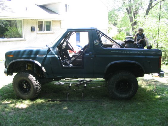

Originally Posted by glennd_05
I know the rock slider thing has already been done, but i figgured i'd show my design
its all made out of 2x3x.120 rectangular tube and 3x3x.25 angle for the mounting bracket
http://premium1.uploadit.org/glennd//P3250110.JPG
slider in place measuring for supports
http://premium1.uploadit.org/glennd//P3250112.JPG
supports cut and tacked in place
http://premium1.uploadit.org/glennd//P3250114.JPG
just needs the mounting brackets now
http://premium1.uploadit.org/glennd//P3250117.JPG
finished piece in front of my FSB
all in all the one took my about 10 hours today, but the second one should go alot fastercause i don't have to redesign for the other side, will post pictures of finished product tomorrow
so what do you guys think of it so far
-glenn

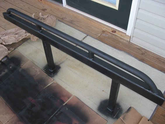

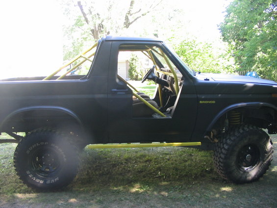

built mine out of 2x4x.25 " rectangular tubing and 45'd the ends to assist with approach angle and welded it to the frame with 2x2x.25 boxed tubing

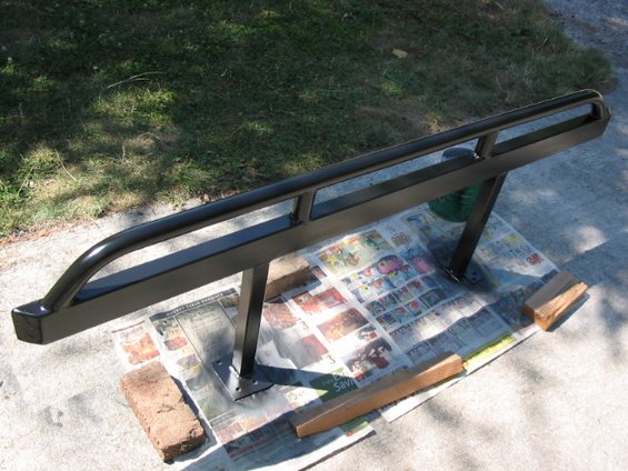

Basically David's design, like Crazed but lighter material for the "slide" portion and 1.5" instead of 2" thick so a bit less loss of clearance, same .120 tube outer:

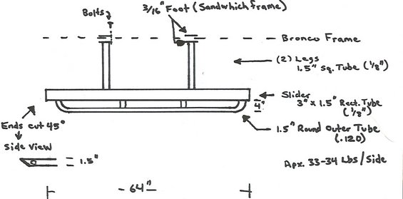

plug ugly 08-07-2005 10:31 PM

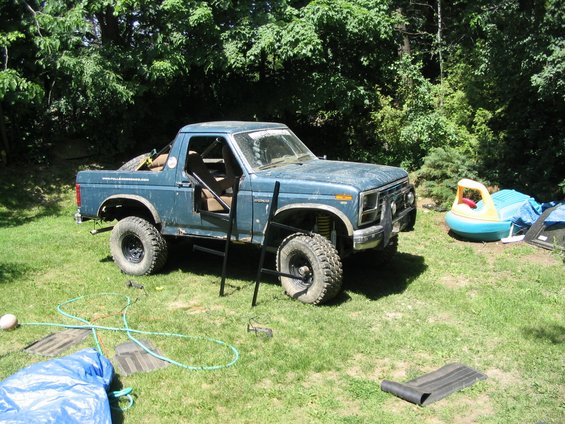

crawler 08-07-2005 10:48 PM

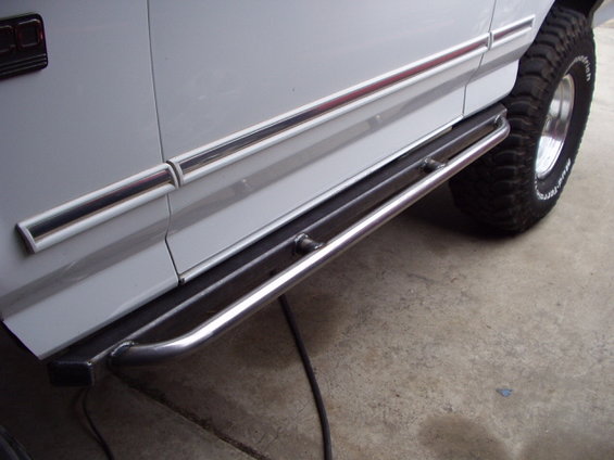

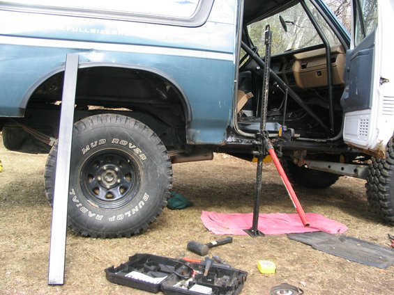

Dustin 08-07-2005 11:19 PM
mine
http://www.supermotors.org/getfile/4...e/P6190008.jpg
http://www.supermotors.org/getfile/1...e/P6190006.JPG
http://www.supermotors.org/getfile/1...ize/slider.jpg
I kinda change up the material depending on how they will get used on a particular rig. I use 2x2 box .120 wall up to .250wall and .120 wall outer 1.5"round tube. Mine have taken all the abuse I can throw at them and have held up great
I might add cage mounts to mine too but not sure on that yet.

Originally Posted by crawler
Front cage to slider mount(now welded up)
how are the sliders tied into the frame? will those mounts hold in a rollowver?
crawler 08-08-2005 12:47 AM
The slider is welded to the frame and then welde to the cage mounts that are bolted throught the body. I have a 12 pt cage all together to the frame and I think it is definitely strong enough for what I do

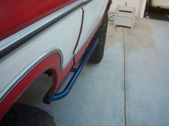

Crazed 08-08-2005 12:51 AM
http://www.supermotors.org/getfile/7...ders%20018.jpg
My frame mounts grade 8 1/2" bolts...fine thread.

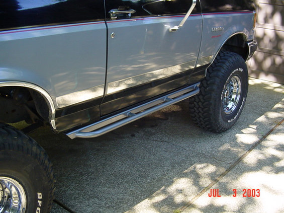

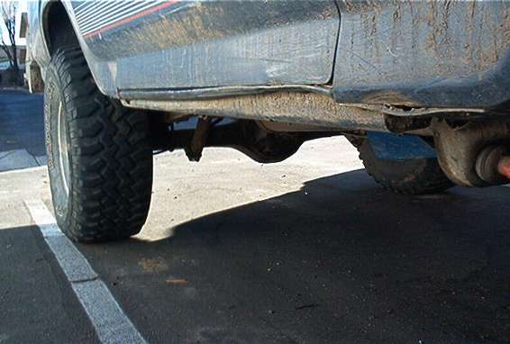

Damager 08-08-2005 12:51 PM

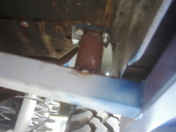

Blown 08-08-2005 03:12 PM

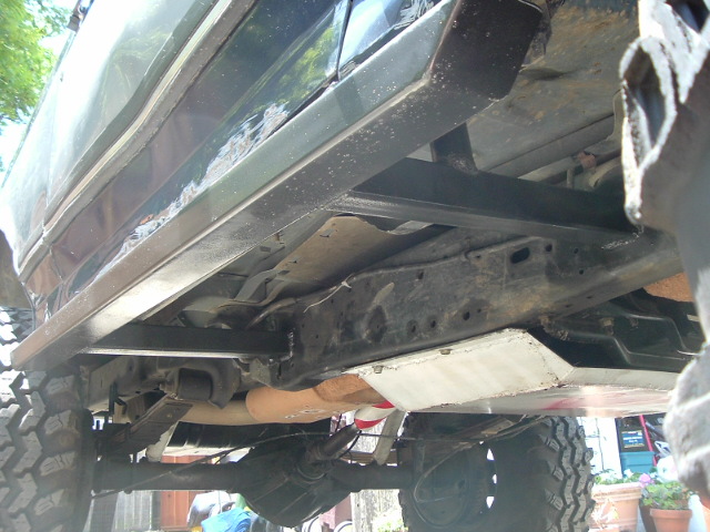

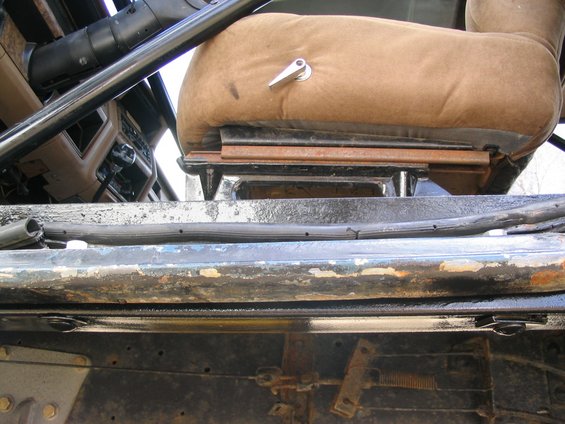

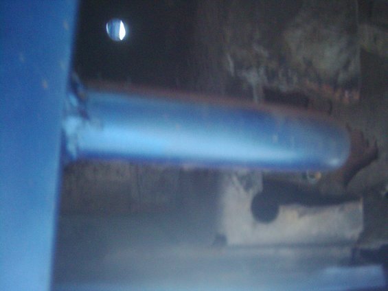

Similar to Damagers: 3" tubing under the doors and bolted through the thickest part of the door frame, angle iron to the frame, and 1 1/2" square slider. These have held-up to several hard side hits and landings. Bottom view:
http://www.supermotors.org/getfile/1...e/DSCN0841.JPG
I siliconed 1/4 thick rubber on top which doubles as spash guard and step traction.
http://www.supermotors.org/getfile/1...e/DSCN0843.JPG

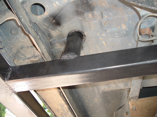

jopes 08-10-2005 04:24 PM

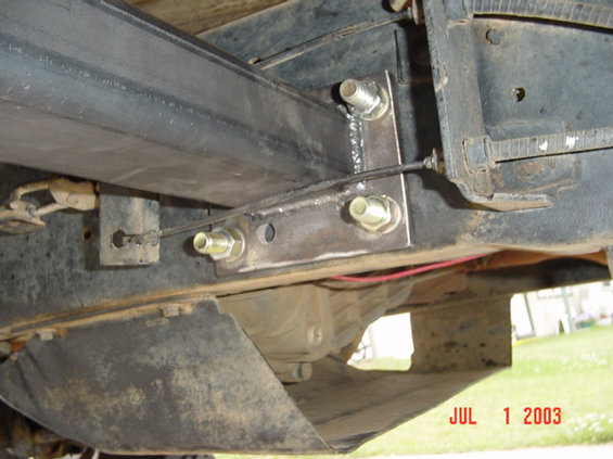

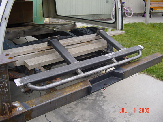

sliders, .120 wall, 1.5" tube, 2" square tube.
http://www.1ton4x4.com/sliders/DCP_5397.JPG
on the bronco
http://www.1ton4x4.com/sliders/ontruck.jpg
welded to frame and body
http://www.1ton4x4.com/sliders/under%20bronco.jpg
another picture showing the 2 leg support design. As well as showing the only dent I have gotten in the 1.5 year of wheeling on them.
http://www.1ton4x4.com/sliders/dent.jpg

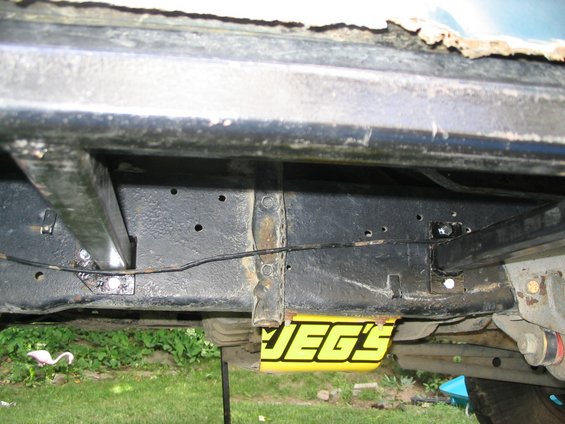

Larston 08-10-2005 07:03 PM
No one has really said anything about this yet. From the research I've been doing, especially in Toyota forums, the hot mounting tip is to position the slider so the main rub rail sits about 1/8" to 3/16" below the body so it doesn't rumble when you're driving and the cab is moving around. That distance will still allow the rail to contact the body when you hit a rock without stressing the mounting pads and frame. Haven't done it yet, but that's how my sliders will be going in.
Larston 08-10-2005 07:06 PM
Are these just butt welded to the frame or do you have a plate on there, too?
jopes 08-10-2005 07:25 PM
plug ugly 08-10-2005 08:40 PM
Yeah, i tried to consider this when mounting mine. not sure how much my cab actually flexes with the frame mounted cage, but I know it does move some.
