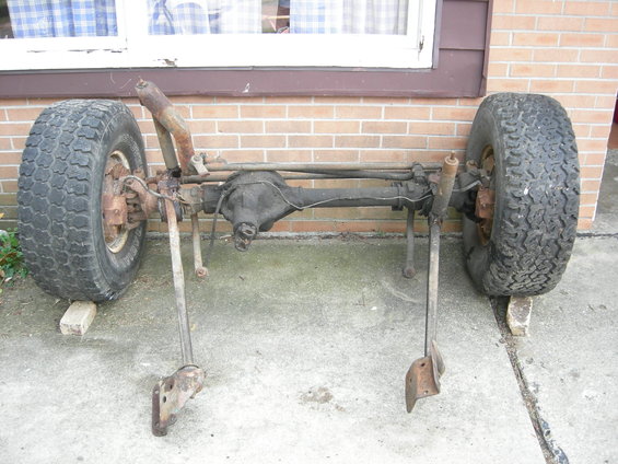

picked this beaut up for $100 last October...let the fun begin :toothless

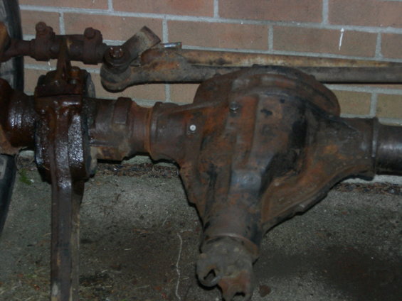

Started to clean it up, lots of PB blast and a wire brush
This is what happens when you don't remove the bolts in an even manor, always ALWAYS the X pattern! Little by little.....I got a little excited.:twak
Started getting cold but i was determined, moved into the garage.
Everything that came off it was it decent shape. Rusty and b!tch to get off, not bad.

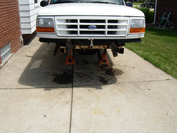

Took a day to get out the IFS:chili:
These were harder to get off than anything else IMO, I hate rivets!
