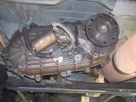

So, I'm bored on a Labor day weekend, no cash to go out and fvck off, so I decide to do something else i've been putting off for too long. Split the T-case and reseal the halves! Yay!
the little tabs on the fork... one is gone, and the other is about done. Looks like I'll be doing a little more than just a case reseal!
Here we go!
