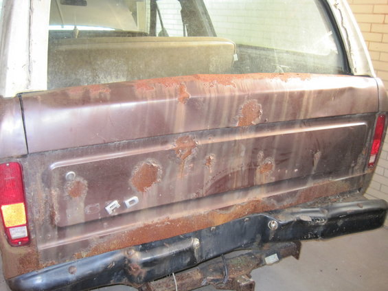

This is the start of my Bronco Buildup. It's something I've been wanting to do for a long time. Finally got enough money to even think about building a Bronco and I finally got in a position that I feel stable enough to take on a project.
So to start with here are some beginning pics,
There's the Bronco!

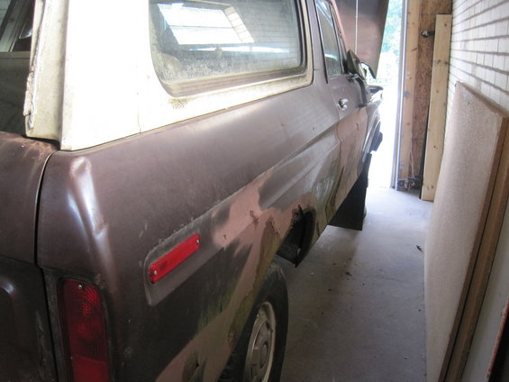

The Worst side, (Driver and rear)
Alittle rust along the passenger side fender,

Man it looks like you have a project and a half on your hands with all that rust.
I agree with you on that one.
The Frame is solid, rusty, but solid.
My plan was to put a lift kit on it and so I wasn't worried about the suspension. Also This truck is going to be subjected to the winter so I will do some patch work to keep it solid but I don't see it being all original.
