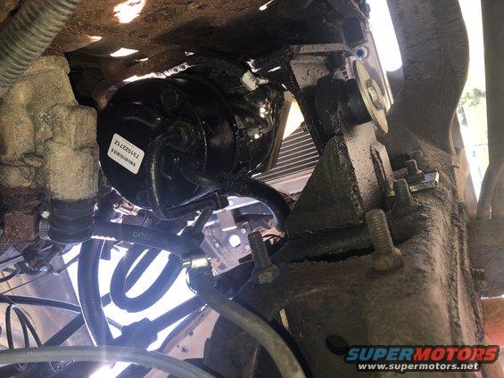

Couple requests. Could you post a couple pics? I'll be swapping in a M50DR2 5 speed and 4bt into my 79 also.
I would like to see what your builder came up with for the clutch slave mounting and clutch pedal to slave rod.
Oil pan clearance on both the axle and harmonic ballancer to cross member clearance.
