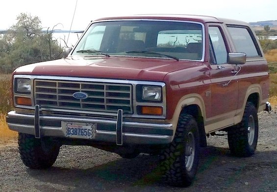

It's a 1985 Eddie Bauer edition with all the bells and whistles. I had looked at several other Broncos, and found a few I liked, but despite the issues it had, this one stood out. I also like that it has a tan interior, which is about the only other color aside from the awesome black interior of my '81 that I could stand. (I even passed up some nicer Broncos because I knew I couldn't stomach the pimp red interior for the next who knows how many years. :toothless)

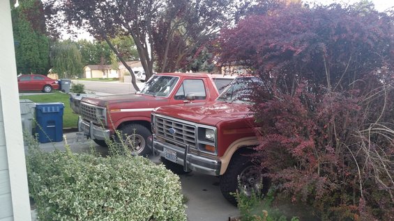

Another set of pictures I took half way home from Seattle. Had to stop and commemorate the new Bronco. I'm hoping the original Ford Bronco tire cover will fit over 32" tires, but I have my doubts.
Here it is sitting next to my '81

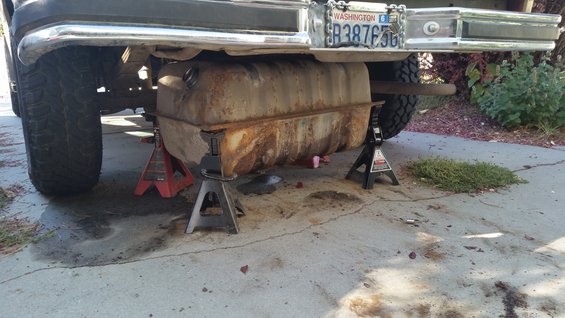

The first project I tackled was the fuel sender, and I'm really glad that I did!
The tripometer isn't working right, so I had no idea how much fuel is in the tank. I figured I'd get it low, drop the tank, and put in a new sender. It'd be an afternoon job.
However.... After I took off the skid plate, I was astounded with how much rust there was. Then, I dragged the fuel tank out from under the Bronco, and there was a trail of fuel behind it. Just moving it ripped enough rusted steel off the bottom to get it to start leaking! I quickly leaned it up so that the gas was away from the side, and there were 3 or 4 good sized holes in it. I could probably punch my finger through the steel if I wanted to.
The skid plate was rotted out as well. On top of that, someone sometime previously had caught it on something and it was dented and ripped.
((And if ANYONE knows how to rotate supermotors pictures, please let me know. They all orient themselves landscape, no matter how the original was taken. Drives me nuts.))
So, time for a new fuel tank and skid plate. I wanted to go with a plastic tank, but it was about $220 shipped and a steel one was about $85 on Amazon Prime. I couldn't justify the plastic one. But, I found that BGY'd upgraded/redesigned skid plate was actually less expensive than a stock replacement from LMC, so I ordered one of those.
1980-1996 Ford Bronco Skid Plate 33 Gallon-Broncograveyard.com
After a week of waiting, they both showed up and were ready to go in. I really like JBG's skidplate. It is nice and beefy, and fit perfectly. Very nice quality piece. And noticeably heavier.
I got some rubber strips from Lowe's to rest between them, along with some new hardware.
I also installed the new fuel sender. I also figured it'd be a good time to install a new fuel pump and strainer, since I had no idea how old the previous one was (I'm guessing original).
The kits also came with new clips and gaskets, so now it's all buttoned up. (I'll post pics of it installed tonight since it was dark last night). The only thing left is I want to grab the 87+ filler neck off of my '81 and install it at a later date.

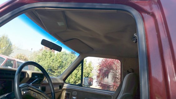

Next was fixing the head liner.
First step was getting it out. I couldn't believe how much needed to be removed to get it out. Everything that holds the headliner in place is held in by something else. All those are held in by something else. Etc.
I even had to remove the dash pad and the rear trim off of the removable top.
I found it amusing that the inside was gray steel. Guess they don't paint it if they don't need to.
Finally, the topper was out.
Unfortunately, event though the middle was sagging, all of the edges were sealed up like a drum. So, I got out a razor blade and slowly cut away until I had some access holes.
I used 3M 38808 Headliner adhesive. Some really nasty sticky stuff, and it worked great.
Reached in through the holes I made and sprayed everything down until it was well coated. Then, started from the center working out, pressed all of the foam cloth back onto the headliner board.
I found the easiest way to install the headliner was to hold it up with my head and quickly attach the essentials (visors and dome light). Don't let it sag on any of these or it'll crack and snap the hard backing.
Once those are in, it'll stay in place.
Next was to reinstall the interior. Lots and lots... and lots of screws.
The hardest part to get in and out was the metal trim that runs along the inside of the windshield. The clips are STRONG. I had to use a good foot and a half long screwdriver to pry and pop them out. If anyone's removing theirs, just remember you're not going to break it. You have to be really aggressive.
These weren't present on my '81 (steel roof) but the models with headliners have two of them on each side above the doors too.
Looks so much better!!

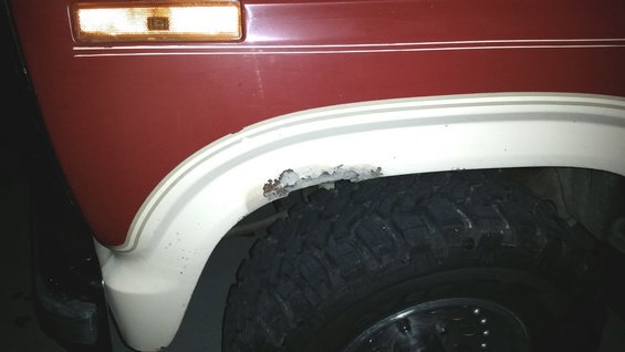

The next big task is the rust repair. The new Bronco has rust all around in the usual spots, so it's going to the body shop today. The shop is pretty cool, they specialize in restoring Mustangs and Broncos (albeit EBs) but they're well versed in them. I didn't know that until after I went there, so I must've had a sixth sense. Also, when I pulled up, they had 3 78/79 Broncos sitting out front that someone had recently given them, so I was a little green with envy.
Fortunately, I've had two front fenders in my garage that I yanked out of a junk yard and have had for probably 8 years now. I meant to use them to fix my '81, but never did. Finally going to use!
The rear right wheel well is rotted out, so I purchased a new full panel from Temco, and the inner fender well is rusted with it, so I ordered one of those from LMC.
The tailgate is in terrible shape too, so I ordered a new tailgate. I saw they just have the lower skin, but considering the inside was rusted out as well, I just ordered an entire new one.
The rear left has some surface rust that they're going to just patch up. (Also going to ask if they can straighten the bumper).
It took a little work last night, but I got all the panels and parts stuffed into the back.
I'll post progress pics while I can, but I should have it back in about 2 - 3 weeks! It'll have a new paint job as well.

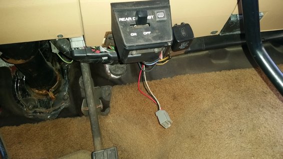

In the mean time, I have a few "what are these?" plugs dangling from under the dash. Both of my previous Broncos were Custom models, so they were bare bones. As such, I'm not savvy on all the extra wiring that goes into A/C, cruise, power, EFI, etc.
So far, the only thing I've noticed that doesn't work is the rear defroster.
Plug #1
If you look closely, the plug that goes into the back of the black box next to the defroster switch IS plugged in, so this doesn't go to that. However, I have no idea what it goes to.
Plug #2
No idea what this is for, but it comes out right in the middle of the firewall behind the brake pedal. Any ideas?
And no, they don't go to each other (unless a connecting wire is missing). The ends are over a foot apart and have different shapes.
