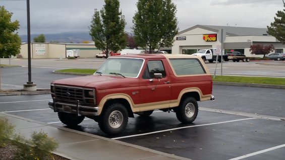

How's the ride of your new leaf springs? Did they raise the rear any?
It's actually really hard to tell if it raised the rear, since I replaced the front coils at the same time. I didn't measure before.
However, there seems to be about an inch or more space between the tires and the fenders, which says a lot.
The ride is amazing. It's so cushy, it's like a new truck. Even off-road, we were going over some serious rocks and rough road, and it was the most comfortable trip I'd ever been on in it.
Ahhh... loved it.
I mean... If the road is bad enough to do this when I misjudged some rocks, and I'm saying the ride is cushy... Yeah, I'm really happy with my new springs and coils. lol

Not too happy about my skid plate though.

That looks like it hit right about where the brace is on the inside of the skid plate. Dented the tank?
· Super Moderator
5,578 Posts
Discussion Starter · #364 ·
I'm not sure on the tank yet. I'm assuming so, although there is about an inch between the plate and the tank. So, maybe not. Either way, I imagine if it's dented, it's not dented very much.
Wow is that one of JBG skid plates?
It is! It's a pretty hefty gauge too! Really came down on that rock, hard.
It surprised us all, since no one saw the drop until after.

Thanks for the report, sounds like what I need. I want to do them before or the same time as my ZF5 swap.
You did a number on the skid plate, but that's what they're for!
