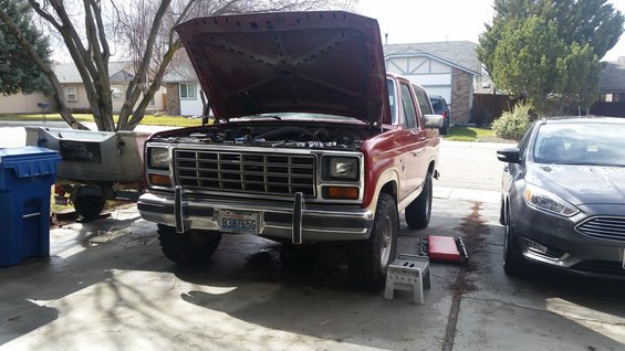

I found myself a nice '85 while I was visiting friends in Seattle. It was in nice shape, but just a little rough. I could just tell it was very solid (doors clicked closed nicely, no rips or tears in the interior), just some cosmetic stuff that needed work, like a broken wing window, cracked windshield, some body rust, etc. Bought it for $1800 and drove it 500 miles home. It has 50,000 on the odometer and I'm imagining considering it's condition, that it's probably 150k. It also hasn't been registered since 2011.
Over the next few months, all of the goodies from my '81 will be going into the new '85. My family tells me I should call it the Phoenix since it'll be bringing the other back to life.
Time for a build thread!
It's a 1985 Eddie Bauer edition with all the bells and whistles. I had looked at several other Broncos, and found a few I liked, but despite the issues it had, this one stood out. I also like that it has a tan interior, which is about the only other color aside from the awesome black interior of my '81 that I could stand. (I even passed up some nicer Broncos because I knew I couldn't stomach the pimp red interior for the next who knows how many years. :toothless)
Another set of pictures I took half way home from Seattle. Had to stop and commemorate the new Bronco. I'm hoping the original Ford Bronco tire cover will fit over 32" tires, but I have my doubts.

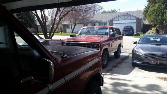

Here it is sitting next to my '81

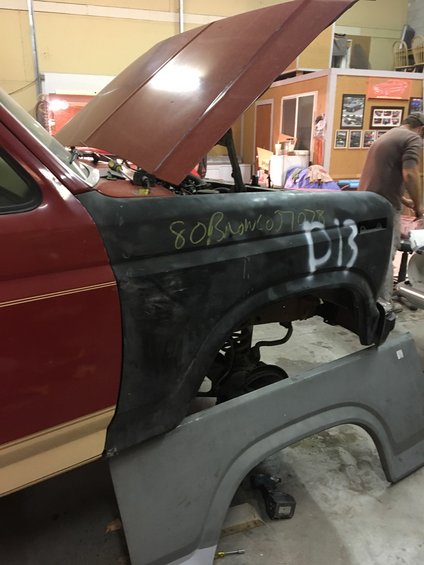

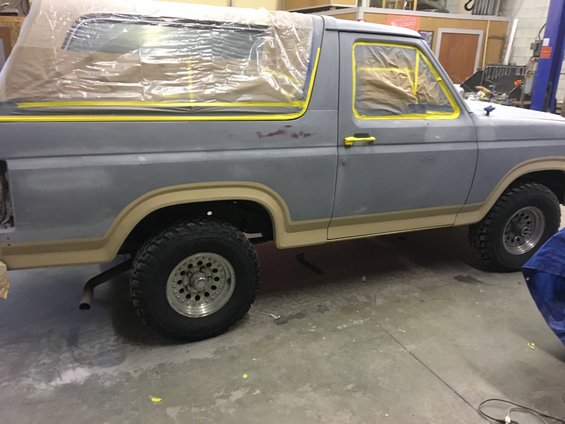

Updates!
The primer is done, and the tan trim. Getting close!

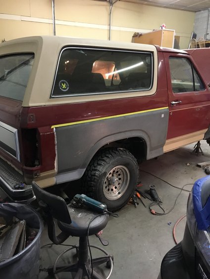

3
Just about there. :D He's still going to add a pinstripe along the two tone, and then, of course, put the trim back on. I should be able to pick it up this weekend.

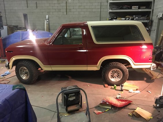

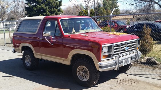

Well, I finally picked it up and brought it home! :D
The bodywork is done well, as is the paint. It's not perfect, but it's very nice. I think a lot of it has to do with that I didn't get a clear coat on top (the clear coat was mixed in with the paint). That was considerably more expensive. But, for $2000 out the door with all the body work, rust repair, AND paint, I got one heck of a deal. He said he way under quoted me and would never do it again for that price.
On that note, the paint is a touch rough. I don't know if that's just the nature of not having a clear coat on top, or if after the paint is fully cured, can it be polished?
Either way, both my wife and I were saying that we're both glad it's not completely immaculate, or we'd feel bad about taking it camping and off roading. :D

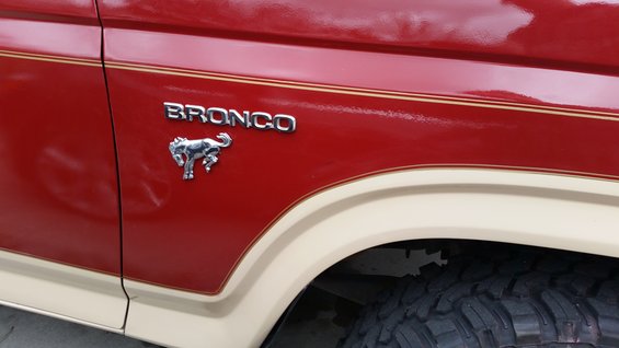

About a week or two before it was done, I had an idea about using the emblems off of my '81 instead of the "Eddie Bauer" emblems that came on it (which were nothing exciting). So, I popped them off and drove down there and gave them to him. I'm so glad I did, I thought it was a great way to customize it.
Next, I've never been a fan of the Ford oval on the grill. I had thought maybe to use the FORD letters from the hood of my '81, but didn't want to overdo it. So, I swapped out the grill. I think it gives it a nice clean front end and, again, personalizes it.
I also don't like the faux wood grain. I've seen some in other vehicles that look nice but I don't think Ford got it quite right and it looks too fake. I got a black one off of eBay in really nice condition and swapped it in (wasn't easy finding one with A/C vents in black). I still need to do the radio one, but that will require some cutting since it still has the knob holes. I'll leave that for another project.
I also used the chrome knobs from my '81 instead of the black ones it came with.
The dome light was also missing, so I got the upgraded LED bulb off of LMC Truck along with the scatter lens and installed it. It's bright. :D
Lastly, the door panels are sun rotted, so I bought some replacements.
Unfortunately, Bronco Graveyard's "light brown" isn't all that close. I'm not 100% sure what to do. Maybe find some interior paint and recolor them. Anyone recommend a brand and/or color for "Saddle"? (The name of the interior color).
Either way, the start of many projects to come! I'm glad it's finally home.

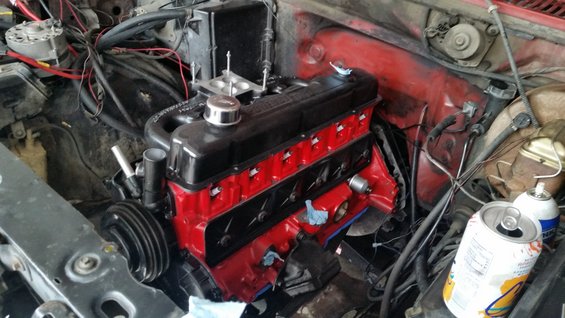

In the mean time, I still need it to drive nicely and be reliable, so I did a tuneup on the 302 in it.
It's the first time I've ever even worked on a V engine! I've never had one before. I've had four inline 6s (a '57 Chevrolet 150, an '87 Toyota Supra, and two Broncos with the 300), and three 4cyls.
I gotta say... I never want to do the spark plugs on this engine again! I bet, in all honesty, that I could swap out the spark plugs on my 300 about 15 - 20 times in the time it took me to change them on this engine. Bleh!
Still, it was nice to pop the hood and get my hands dirty. Full oil change, spark plugs, air filter, timing, etc. Seems to run a bit nicer.

Now you know why I was so thrilled about working on a 6... v8s are a major pain. Imagine fitting long tube headers on one.

Heh, yes. For sure. The 6 is so easy to work on. I'm used to THIS when doing spark plugs:

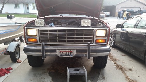

Next on the list. The headlights on this were pretty bad. I don't know if it was something like a bad ground somewhere, but they didn't offer very much light and driving at night was not fun. So, last night after work I pulled the heavy duty headlight harness from my '81 as well as the H4 bulb conversion headlights I had installed.
http://www.fullsizebronco.com/forum...o-graveyard-heavy-duty-headlight-harness.html
Before the install:
Since I was running wires and such, I found it easier to just remove the chome trim, since it allowed me a bit more room to work.
Installed and lit up. Granted, it's a lot darker than when I started, but still. Nice and bright!

New lights look good! The original setup on these old girls only takes you so far, this is something i will be doing once my truck gets running.
Yeah, it sends power through the switch itself so they had to limit how much juice they got. The new wiring takes it straight from the battery to the headlights and uses the original headlight plug as an on/off for the relay. I love it.

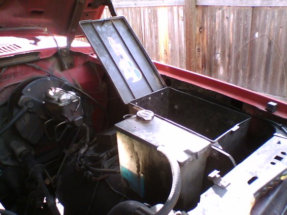

Also, would you want to see the under hood toolbox from the 81? ;) I had one in my 85 that I sold about 5 years ago, and want one to put in my new 86
Got one in my 81! :D My brother found it for me in a junk yard and I swapped it in long ago. I love it and use it constantly. Filled with carb tuning stuff, roadside tools, etc. They're awesome, especially since they bolt right in. Bummer that you didn't pull the one you had, I've NEVER seen another one.

Just fyi, a normal military surplus .50 cal ammo can fits perfectly under the hood. Since I have a second battery in the factory toolbox spot, I'm gonna fit it on the passenger fender liner. I have TONS of room over there. They are cheap, durable, and watertight.
That's what my brother uses in his. It's pretty slick. It's just cool to have something that's stock (and rare) :D
