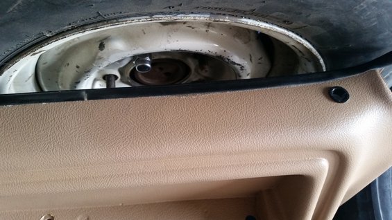

Does anyone know what this little piece is for? It looks like a delete of some kind, but I have no idea:
That is where the interior spare tire mount attaches. I never knew there was a little cover that went over those holes!
  • Like
Reactions: 4
Cool! Thanks, that really had me wondering. That totally makes sense now. :D

Yea, I was going to say the notch was for the inside spare. I think I have one of those inside spare tire carriers around here somewhere.... The hardtop trim also has a notch for it as well.

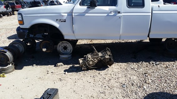

Well, this followed me home last night!
After this incident:
https://www.fullsizebronco.com/forum/7-1980-96-bronco-tech/496410-heater-box-caught-fire.html
I was out in the junk yard getting a new heater box. I found one, pulled it (not too bad, but nearly as easy as one without A/C), and then was walking through the rest of the yard to see what might peak my interest.
I was just about on my way out when I noticed a '95 that had the hydraulic clutch master cylinder in the engine bay. The emblems were gone, so I had no idea if it was an F150/250/350, etc.
Peaked in the cab and saw the shifter coming through the floor (the shift handle was removed). So, the transmission was still present.
Crawled underneath to see what it might be and... it was a ZF5. Not only was it a ZF5, but it was 4x4. So far so good.
I couldn't tell what the engine was, so I still had no idea if it was a small block, big block, or diesel. Checked the tag on the transmission and it was a 5.72 ratio, which means gas motor.
Sill, big block or small block?
Pulled out my phone and tossed in the VIN off the door, and lo and behold, it was a 5.8! :D
I called a buddy of mine and the two of us pulled the whole thing out in about 3 hours. They don't allow jacks in the yard (don't want vehicles falling on people), so we had to get clever with a strap and a come-a-long (actually worked super well) and drop it all down.
The transfer case was a BW1356, so I took that too to upgrade my 1345.
All in all, for the transmission, transfer case, shifters, cross member, and transmission hump cover..... $315 out the door.

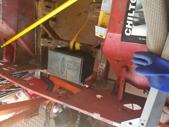

Look what Tommy found!
A guy in the stix was selling a bronco cheap. I saw the underhood toolbox in the photos, probably could have gotten it for $5, but at least offered the guy a fair $50. Still a steal. Havent found one since I sold my truck with the box still in it years ago
