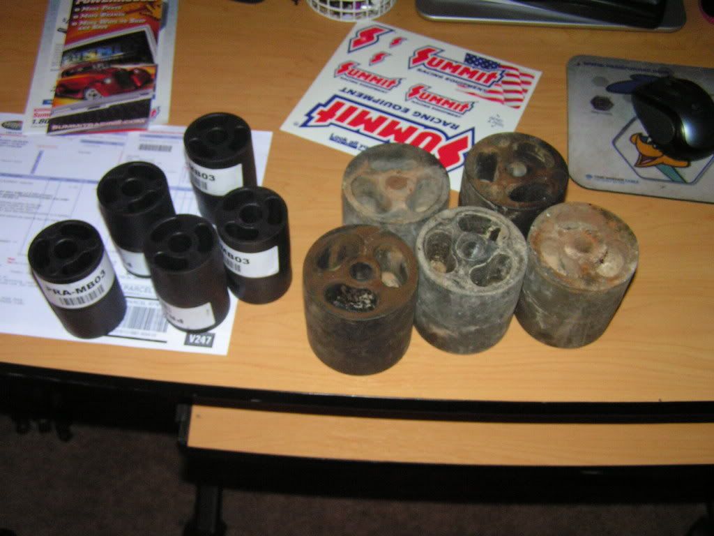

When I bought the Bronco it had 5 3" spacers in the back, i know i need a total of 10 so i got on eBay and bought 5 more but when they got to my house i realized I'm a dumb ass cause i didn't check the width of them:banghead. so my question is will these work and are they safe?? I would rather cut my losses than install something that could put my or someone else's life at jeopardy
they are 2" wide

yeah the small one increase the possibility of them punching threw the floor

Just got off the phone with the company and he siad they would work but might as well sell them all on ebay and just buy the kit cause i didnt know i needed a steering shaft extention aswell as a bunch of brackets.
But thanks for all the replies guys

There is no bracketry for the Fseries/Bronco. Only thing that has to be done if you have a auto tranny. Is extend your shifter actuator rod. There is a 3" round stock that you have to cut and weld in to extend the shifter actuator rod.
