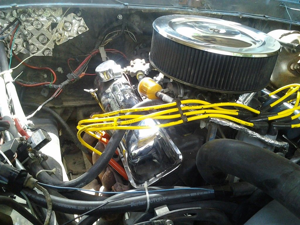

Ok I started a thread a couple of years ago about my 390 in my bronco missing and cutting out. I am still having trouble. When the engine is cold and it pulls hard with the rpms low it sounds like it it hitting on about 5 or 6 cylinders. If you go to a lower gear and raise the rpms it goes away. Once warm it cuts out very slightly on a long hill with low rpms. Once the rpms go up it runs like it should. Here is what I have replaced, plug wires, plugs, control modular, coil, pick up coil, wiring harness from dist to the modular, switch, I have also made the carb a lot richer and replaced the gaskets under the carb. I have done a compression test with engine cold, it ranged from 135-150. The vacuum is 16 at an idle. I dont know what else to chance or check. Could it be the intake leaking? What ever it is gets better once the engine is warm. I have sprayed stating fluid ever where and found a small leak under the carb but replaced the gaskets and now the leak is gone there. I dont know how to check the intake because most of it is under my valve covers. Any ideas would be great. I need it fixed this is my daily driver and camper puller.

I see you have an adjustable fuel pressure regulator tucked in there. have you tried lowering the fuel pressure? I had a similar problem once because the electric pump was blowing the needle off the seat and spilling through the vent tube at low RPMs. Once you got it wound up it wasn't noticeable. I also noticed you have and edelbrock or carter. Which side of the carb did you lean out? the primary or secondary? if you only leaned out the front side, i would say you have a lean stumble on the primary and once you open up the secondaries the lean spot goes away because now you are supplying enough fuel to the engine. Also, how did you lean the carb out? just slide some new bigger metering rods in or change jets too?
EDIT: you made the carb richer not leaner. My mistake. Scratch that last part.

I dont have to open up the secondarys to make it smooth out just raise the rpms. It is a 600 edlebrock. The fuel pressure is at 6 psi
