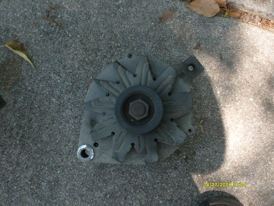

Sorry to ask everyone a stupid question, but I feel like an idiot most of the time as it is. Anyways, I think this is a 8pm ALT right?
Im trying to order all my stuff for my 3G swap, cables, connectors, and the alt. Does anyone by chance know the size cables I need for the 3G alt? Im not near my Bronco, prob wont be for a couple days and I want to order it so I can put it on when I get back.
I was gonna order 2ft of + battery cable and 3ft of - cable from Ryan, and all the other stuff I need plus the alt. But I wanted to make sure Im ordering the right clocking, 8pm? And also the length of cable I need for my charge cable setup? And I assume I should order a new pulley? Does size matter? And one more thing, what size fuse should I get with the charge cable?
I appreciate it alot, as usual! Oh and heres a pic of my alt SITTING the way it sits on the engine.
11,042 Posts
Kinda hard to tell the clocking from the front.
Just order a wiring kit from Ryan, he gives you like 5 or something feet of wire... The setup he sent me was more then enough to do the job.

You're talking about the new charging cables right? I saw the pic of the clockings pics, I was staring at it for prob 20 minutes trying to picutr it backwards, I guess ill need to just look at the ALT. And figure it out.
