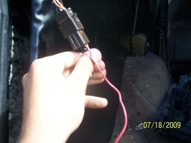

Find the plug under the driver side panel and "tap" into the red/green wire (make sure this is the correct wire by pressing the brake light with a tester attached.) Put wire under the carpet or the black trim at the base of the carpet to keep hidden. Than ground the black wire behind your back panel. I have an amp so i used my amp ground.

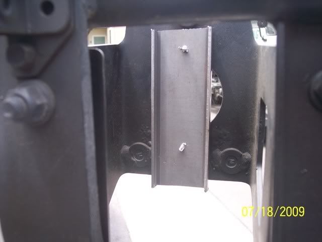

Attach the 6" piece of C-Channel to the tire carrier. Drill a hole big enough to fit two wires through and mount the light to the C-Channel. Than attach wires.
Make sure you use wire grommets or something to protect the wires from being cut by the metal. I used black caulk because i didn't want any water seeping in (i had and extra tube) It should look like this when done.
