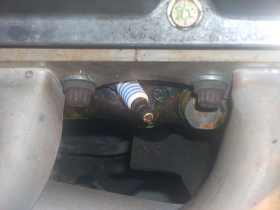

worst case, I'll warranty the assembly, But I just dont want to go though all the install again.... I might get dirty!....again! (the scared to get dirty part was a joke.)
I mean, It looks like its coming from the head bolt holes, and if I can, I'd rather get some ARP bolts and do the head gasket.

is there coolant anywhere else? when my water pump leaked due to bad sealing on my part it threw coolant back there. just a thought.

Based on the location I would say a cracked head. Based on the color it isn't from freezing. I would do a coolant pressure test, that should help pinpoint the exact location of the leak.

I would bet its eather A) from a head bolt hole. there open to the waterjacket, and need to be sealed. If not, they leak. Or B) A cracked head.
