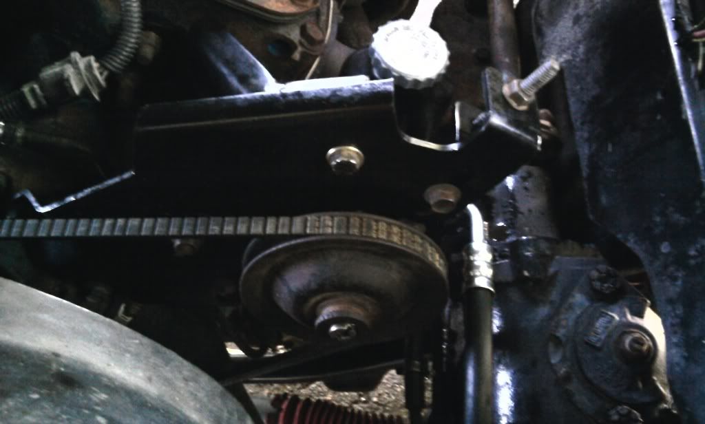

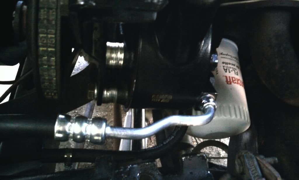

I put a van pump 207878 on the truck lastnight. Bolted up awesome and changed the high pressure fitting on the pump to the old one. Had to go get a sag pulley from the scrap yard. Now i have everything hooked up. Ill bleed it today and let you know how its working. And pics
100 Posts
Discussion Starter #11
Everything seems to be working good. Now the setup is 1977 ford LTD bracket, 1988 E350 pump #207878, and high pressure line from the 1979 bronco. Here are some pics. Thanks Guys:thumbup
