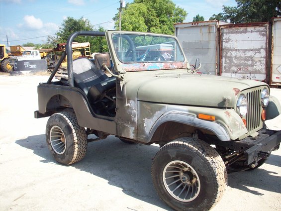

Back in July I bought a 78 CJ-5 that I posted about a while back. Since then I've started tearing it down with plans to do a resto/trail rig build-up. I'll keep this thread updated as I do stuff.
This is what I started off with

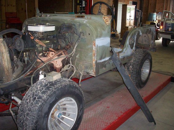

Then in August I started tearing it down. First to go where the seats, hood, roll bar, and center console
That start of the pile of parts
Then the next weekend I pulled the feneders, grill, windshield frame, and part of the dash (had to go buy torx bits)
The pile of parts grows
You can see the brand new poly bushing kit that got thrown in with the jeep.
More pics can be found here
The more I tear into it, the more little things I find wrong with it. But that is half of the fun of a project like this.
I am going to do some more work to it this weekend and I'll be sure to post up pics when I do.

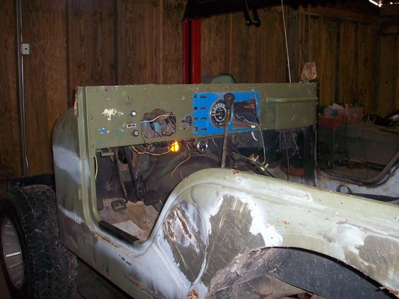

Well I was finally able to get back to the Jeep this weekend after some set backs (lost my job, then my mom passed within a month of being diagnosed with cancer) I got the new dash bolted in. and all of the wiring except the rear done. Which leads me to my problem. I got everything hooked up and hooked the battery charger to the positive and negative battery cables (per painless' instructions) go to crank it and nothing. when I turn my key it goes to start, but doesn't return. to run, which leads me to believe that the ignition might be bad, but it won't fire when I jump the solenoid either. There are wires for a neutral safety switch that I did not hook up because the jeep does not have one and it ran before I tore the old harness out. I also do not have any of the gauge wires hooked up because my jeep came with manual gauges (oil and temp) and it is not in the cards to buy new gauges atm. Am I missing something? do I need that neutral safety switch for the painless kit to send power to the starting system? I will be calling painless in the morning (it's a pain that they aren't open on the weekend :brickwall) I was just hoping that maybe one of yall could give me some insight. The plan was to sand blast and prime next weekend and paint the weekend after. now that is getting pushed back at least another week because I need the jeep running to get it out of the barn and into the paint booth. Well on with the pictures.:thumbsup:
New dash with steering column reinstalled
Pictures of the wiring process
Possible location of safety switch?
Or?
Gave my Jeep a black eye(broke the light pulling the old harness off)
Other picture can be found on my supermotors page
http://www.supermotors.net/registry/19083
Thanks for looking and hopefully someone can shed some light on my issue.
