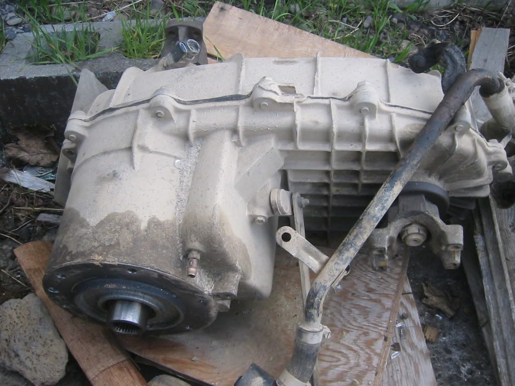

Okay, so I'm parting out my 86 Bronco and I have a guy interested in my T-Case... however! he needs a 205, which, if I recall, discontinued in 79 or so. I know my 86 has a Warner T-case and I was curious if, by some far-fetched chance, that the Warner will bolt up to this guy's 78 C6 tranny.... Perhaps a stupid question, but I've been asking around and no one really seems to know or they just don't feel like taking the time to figure it out. I've done some research and I'm not too optomistic, but figured I'd ask.
A picture of the t-case if it'll help. Appreciate the help!

The answer to will it bolt up is yes. BUT... it won't fit the 78/9 Bronco without some work on the driver's side frame rail because it's wider than the 205.

Think it'll fit an F150 of the same year (78) or would it require the same modifications that a 78 Bronco would?
