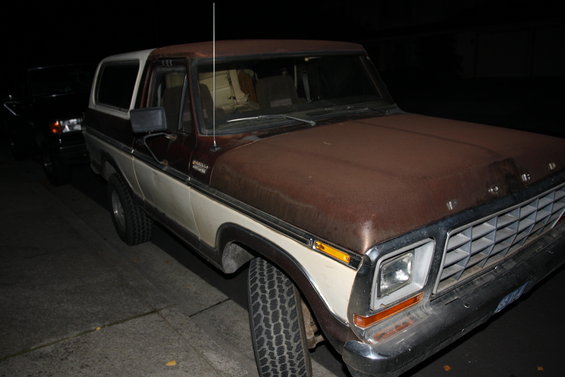

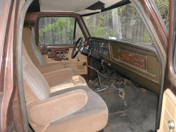

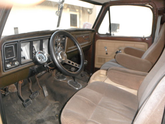

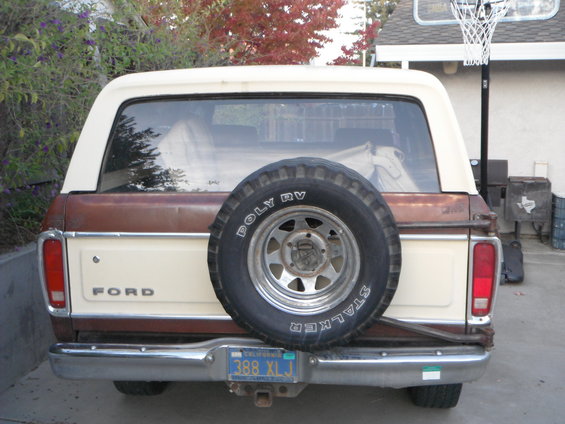

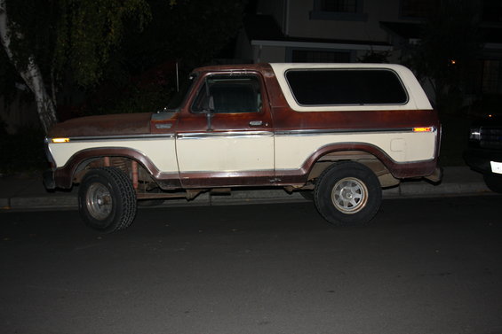

I figured that since I am working on my impulse buy of the year, I might as well as start a thread on the work I am doing and get some feedback on the progress or advice on what to do next.
The story of this rig is that I was happy with my DD (89 351W C6 EB) and working on it. Then I decided that I really liked the looks of the 78/79 gen, and for whatever reason, I started to search on CL to see what was out there and what they were going for. Anyway, short story is that I found a rig for $925 (the guy bought it from a tow yard on a lein sale) and it seemed rough, but a solid rig. I drove it home late that night...wife following me close (no registration for several years) with the Bronco sounding like there were marbles in the wheel cover hubs. Talk about freeked out as I drove home!!!!
Anyway...made it home and parked it. Then buyer's remorse set in. What the hell had I gotten myself into and what were the neighbors gonna think about this P.O.S. of a rig sitting in the middle of our nice neighborhood!
The remorse soon went away as I decided that I would breath some new life back into this old boy and get it into good shape and make it into a nice rig. So the work begins.
Here are some pictures as I brought it home that night.
