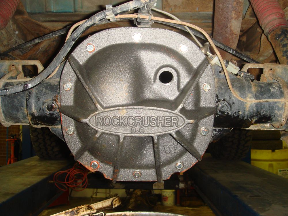

It was time for a fluid change and an upgrade to the rear diff cover. Pick up appropriate differential gear lube and some RTV sealant at you local parts store.

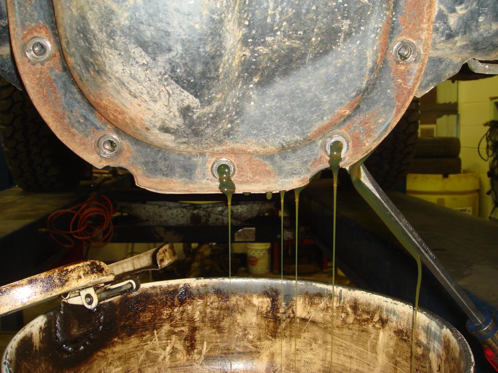

Start by removing the bolts that hold the cover
Leave 2 or 3 bolts loose in the top to help control the flood of fluid that is about to come out.
Use an old flat tip screwdriver to pry the cover off. Use caution here so you don't scratching the mating surface.

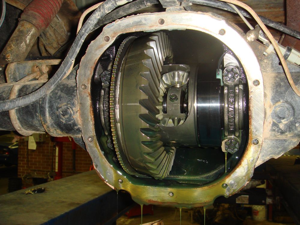

Check the gears for wear and damage, now is a good time to grab a coffee to let the fluid drain out.

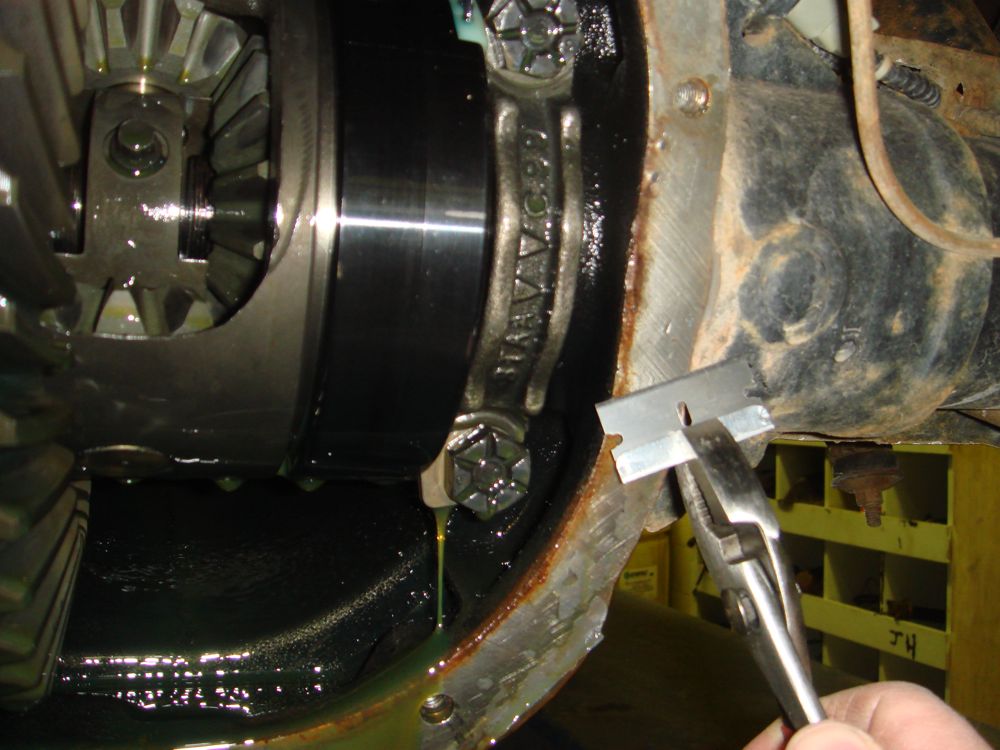

Scrap the old gasket or silicon off, I also use brake clean to clean off the gears and help remove any residue gear oil.

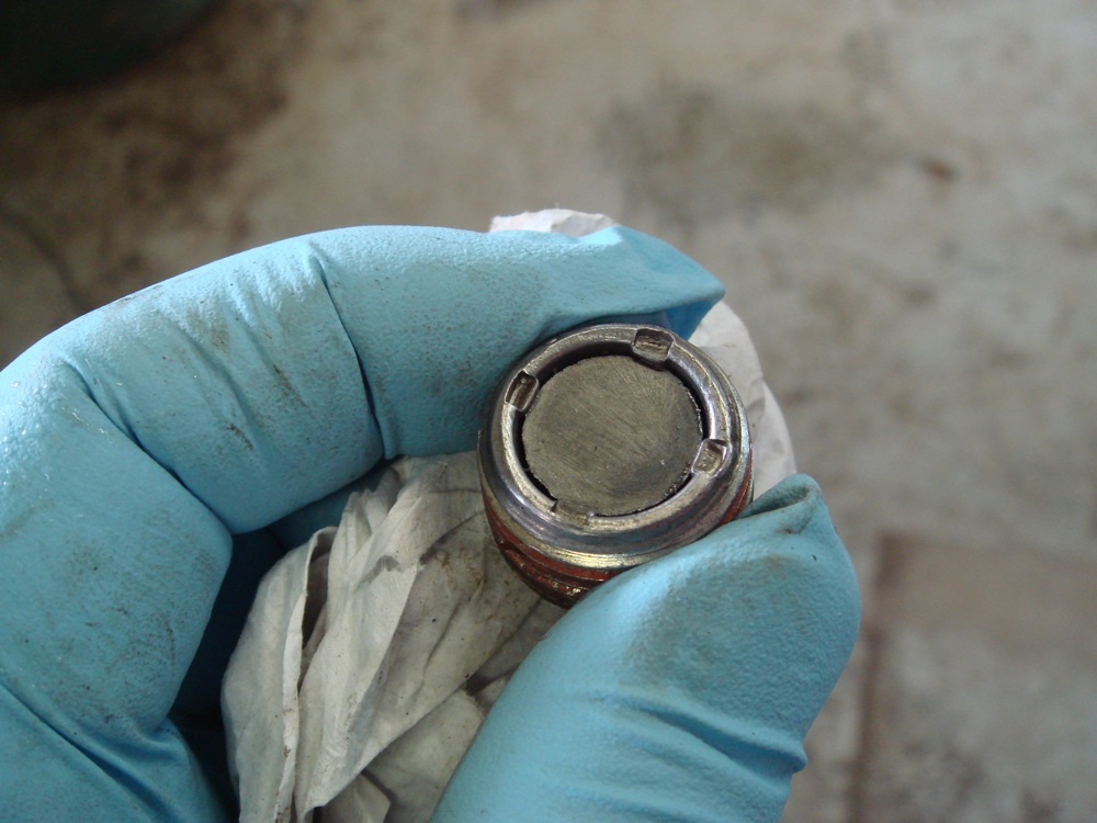

Remove the fill plug
Inspect the plug it for chunks of metal. Small particles are normal, but anything large is cause for concern and will need to be investigated. Clean any metal shavings & sludge off the plug.
Use some brake clean
Use some brake clean to help remove the fluid

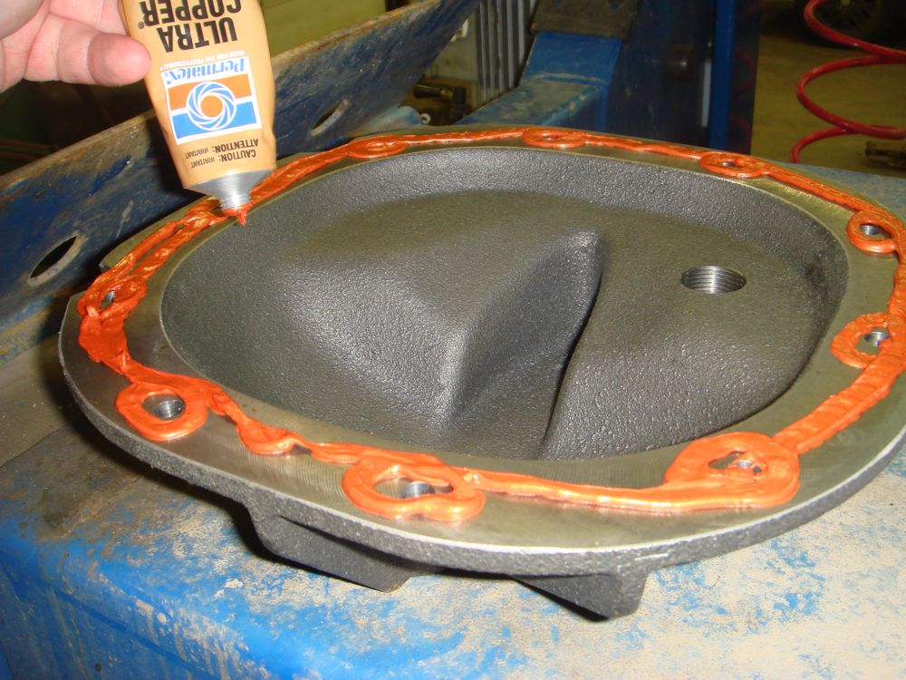

Now would be a good time to upgrade your differential cover, apply a bead of silicone gasket to the cover for a leak proof seal - I used Permatex® Ultra Copper. The permatex instructions state that you should immediately install the cover, then tighten the bolts finger tight. leave it 1 hour, then tighten another 1/4-1/2 turn. This helps ensure you are not squeezing it out. It fully cures in 24 hours, so try to make time to let it sit a few hours before putting the gear oil back in.
Install the cover and tighten down the bolts. Torque the bolts to spec. Do not over tighten as this will cause the sealant to squeeze out and may result in a poor seal. Consult your service manual for the proper torque specs.

Now is a great time to paint the cover, clean the cover with some brake clean, cover the areas you don't want paint and spray.
Doesn't look so bad!:beer Now go for a drive to warm up the fluid, check the level it will likely need a top up.
*Please dispose of your old fluid at a local oil recycling station, not in the trash!:twak
Note: the rockcrusher cover was purchased off of ebay for 60.00bucks, for heavy use I recommend you buy a cover from Ruffstuff Specialties. Click

You shouldn't need sealant on that drain plug. I use anti-sieze. I'm not sure I could have gotten it out if it had been sealed in.
I do it all the time it comes out nice and smooth, just extra insurance is all had one leak once.

Since you're up north did you use a standard 75-90W? And why the "copper" gasket maker, I think I just use the ultra black since it takes some pretty high temp extremes.
EDIT: found it, but how come you are using an 85w-140 gear oil, you tow heavy loads????

Here are a couple links for permatex gasket stuff to possibly use:
http://www.permatex.com/products/au...mum_Temperature_RTV_Silicone_Gasket_Maker.htm
This is the one I prefer:
http://www.permatex.com/products/au..._Oil_Resistance_RTV_Silicone_Gasket_Maker.htm
