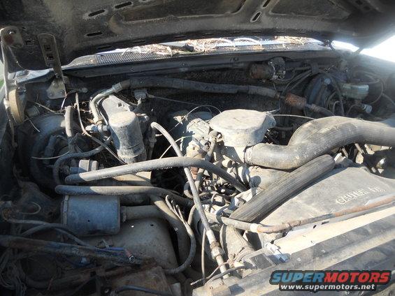

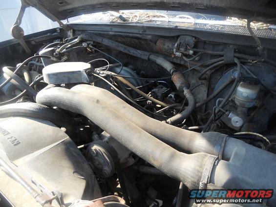

First I would like to say how much I have enjoyed this site, and ALL of the helpful members - hopefully I will be able to add some additional ideas/insight to other members with my resoration/custom build of my 91 FSB XLT 351W - dress in Black with Oxblood Red interior.
I have some big changes to make, to bring her back to the original luster - and some select upgrade to help make her better..

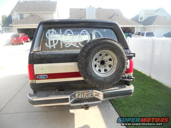

I found her sitting in a field - the PO tried starting on an empty tank - could not get her going so he drained the radiator and let her sit. Other than the front bumper she is complete with a 3in body lift and 33x12.5 VERY worn tires - and dropped him to 7 bills - loaded her up and left.
New parts on order/ready to install - water pump, thermostat, serp belt, hood latches/hood springs, carpet, cables, silicone hoses, vacuum lines, fuel filter, fuel hose -etc..

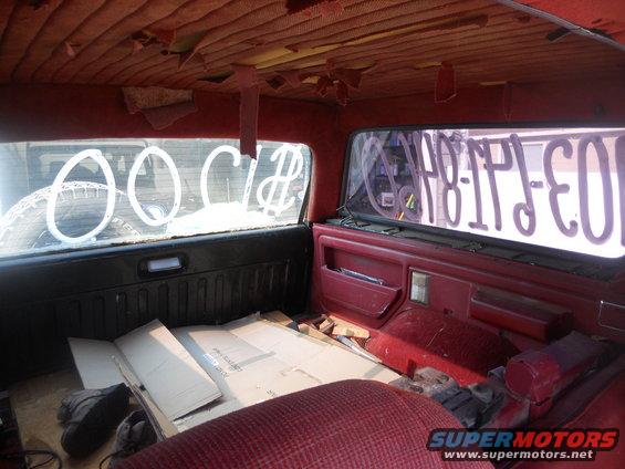

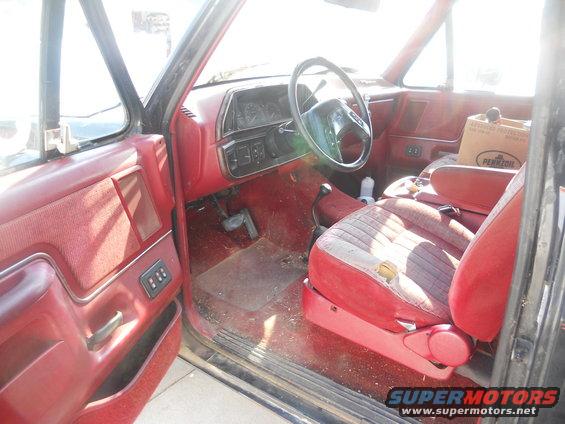

The intrior had crap all through it -
Interior will be finished out in Oxblood Red and Black - for the moment keeping the stock seats - just rebuilt and covered - probably micro suede - carpet red, door panels/dash/trim in red with Black accents.
