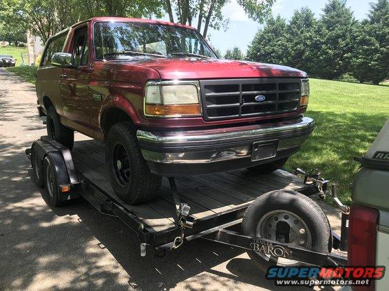

So I bought a another bronco this morning. Wasn’t particularly shopping for another one, but I’m always looking and couldn’t resist. Been watching it on Craigslist for weeks. But I picked it up today for $1900. Most money I’ve ever spent on the initial purchase of a bronco, but I’m satisfied with my decision. After dragging it home..
Someone repaired the rust on the rear fenders years ago. They did an ok job but one of the fenders is starting to bubble again. Also both front fenders have rust at the bottom. A small amount in both rocker panels, and also the rear corners of the bed floor. Overall it’s not very rusty underneath though.
