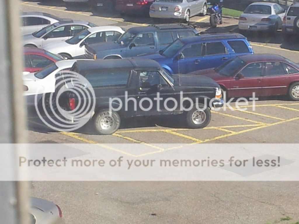

Just picked up a '96 full size eddie bauer edition with a 351 for $900. Motor has a lifter rattle and it is a little beat up, but it made the 2 hour drive home so I can't complain.
The previous owner cut the exhaust right before the cat so I just have 2 pipes coming down off of the manifolds. I want to have the exhaust dump out the back so I am not getting high off the fumes while driving. I would rather not run a cat just for price, but I can't find any y-pipes that don't include a cat. Can anyone give me any other options other than dropping $350 for a new y-pipe cat combo?
