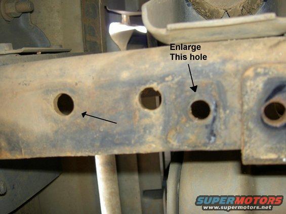

Front of the frame with the swaybar gone:
You have to enlarge one hole a little bit to get the bolt to go through it. You will have to grind around the nut part of the nut bracket to get it closer to the frame, too:

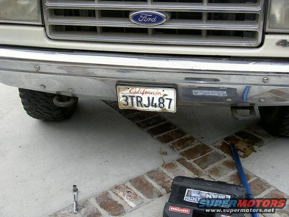

Finished product:
The hooks almost look factory. They are on perfectly straight in that pic, the bumper was off by a little bit when I took that pic but I fixed that afterwards.
